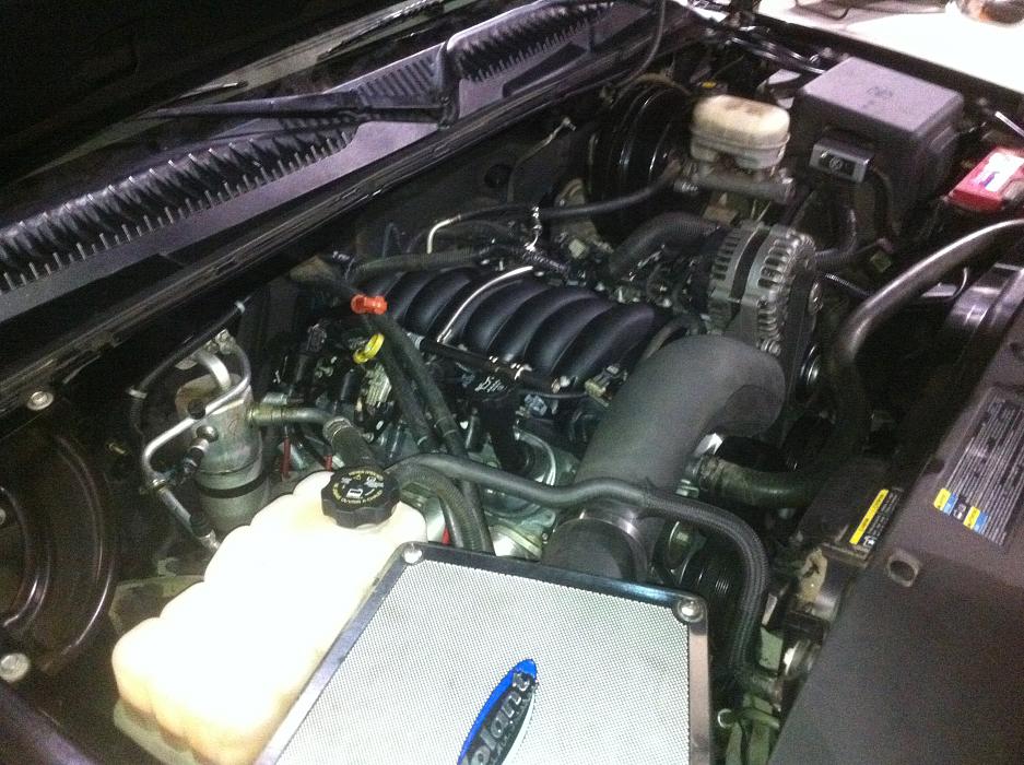

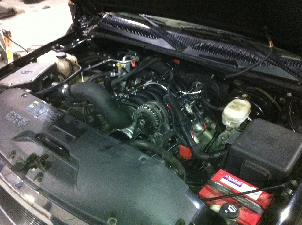

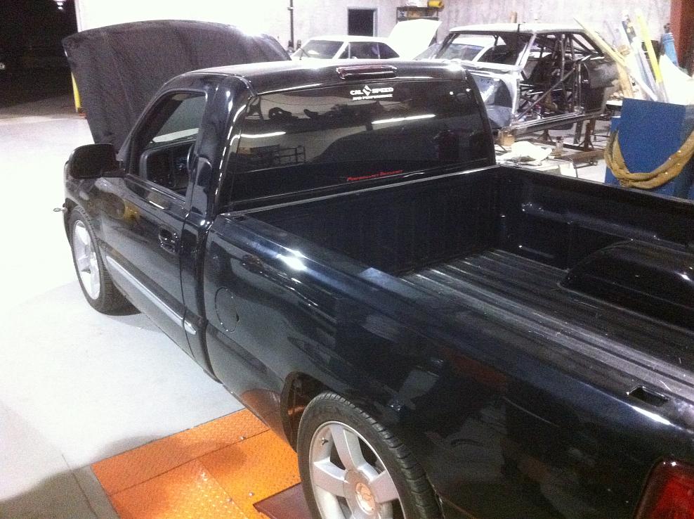

Here's some pictures and video for you Derek at bottom:
Cant be giving out COD specs lol
Its still got alot in it if you decided to. But very impressive numbers for a mild/good budget combo. It costs ALOT more but i've seen up to 480 on same combo with milled heads, one of our ported FAST intakes, YT rockers, Underdrive, shortbelt, better headers/exhaust -1-7/8" headers /w good 3" Y to 4" collector / 4" Elec Cutout (replace those AEM headers with 2.5 collector and crush bent homemade 2-1/2" y that goes 2-1/4" in the bends and 3" merge etc)
and 500+ rwhp with CNC LS3's... But you've got a monster that way it is with a real simple combo that is very budget friendly.
Attached Thumbnails Just got back from the dyno!!-img_2632.jpg   Just got back from the dyno!!-img_2628.jpg   Just got back from the dyno!!-img_2625.jpg   Just got back from the dyno!!-img_2624.jpg
