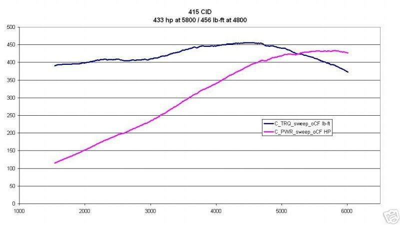

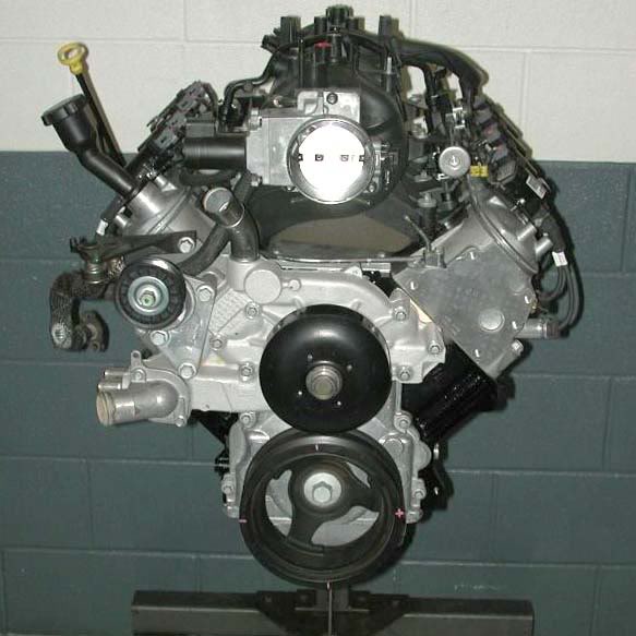

Thanks, any information is appreciated. I do have one dyno sheet (engine dyno) from a 414 CID engine that Lingenfelter Performance Engineering sold on ebay. They built several strokers for a Detroit manfacturer (probably GM), but the man I talked to at Lingfelter a couple of years ago when these were auctioned wouldn't say for sure. He said they were built as power sources to do drive train testing on transmissions, etc. to really load them up with torque for hundreds of hours to see what it took to make them fail.
This engine had the Lingenfelter GT-7 cam which is a 208/230 with a 121.5 LSA and about .550" valve lift (intake and exhaust).
Here's a spec sheet and dyno graph of the engine off of eBay.
