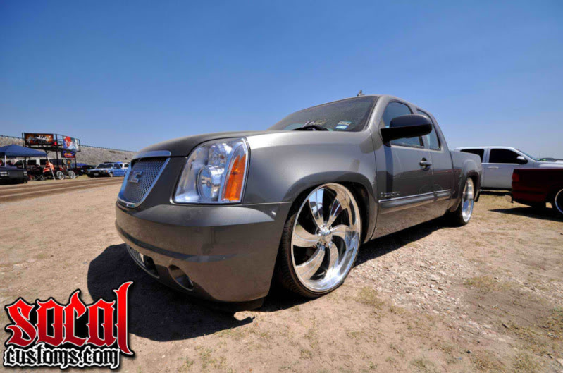

It all started when I upgraded the brakes on the 2011 Silverado to the Willwood set up. I'm happy with the set up and application.
Only issue is the existing wheels interfered with the caliper. I've been unable to find a set of wheels I want to go with. All indications are that the best application will be a 24" wheel.
I am considering a set of 26 Intros and went as far as obtaining one to have a fit check performed. I hear the Intros rub on bumps and certain driveways. What makes this a bit complicated is that I am in the north Seattle Wa are and my truck is in Florida. So a lot of these fit checks and results are what I'm being told as opposed to what I'm witnessing.
Any guys riding 26 on 2011 have significant rubbing issues. Did you have to do some exensive modification to get it to work? I don't want to do that and am preparing to return the wheels if extensive modification is required. Thanks in advance for any help / advice.

Buddy had a set of 26" intros all around and he did have to notch the firewall to be able to turn this is the only pic i have of it

I could be wrong but I think Intro only makes 26X10,with that wide of a wheel you will have to tub the front fenders and cut the firewall like he ^ said on a 6" and lower drop.

Well damn. That answers that. I appreciate the feedback gents. I'll order some 24s and put this behind me. Thanks again all.
