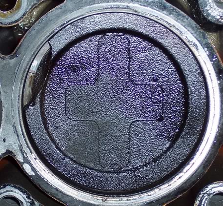

Speaking of stock 5.3 internals and boost....

That sucks
looks like a little detonation issue breaking off a ring land
how much boost when it happened

9psi. I think the tune was off but I didnt have a wide band or fuel pressure gauge at the time. That happened my one and only track pass, 1/8 mile
Didnt hear any detonation but with the blower and exhaust I guess it would be pretty hard to hear.

Ouch man! sry to hear that.
well maybe it's time to put forged piston and rods to make it stronger.

I swapped in a 6L after that, blew it up and now have another 6L in. Its holding up good since I have all the right tuning tools now.
Forged pistons may be in the future.
