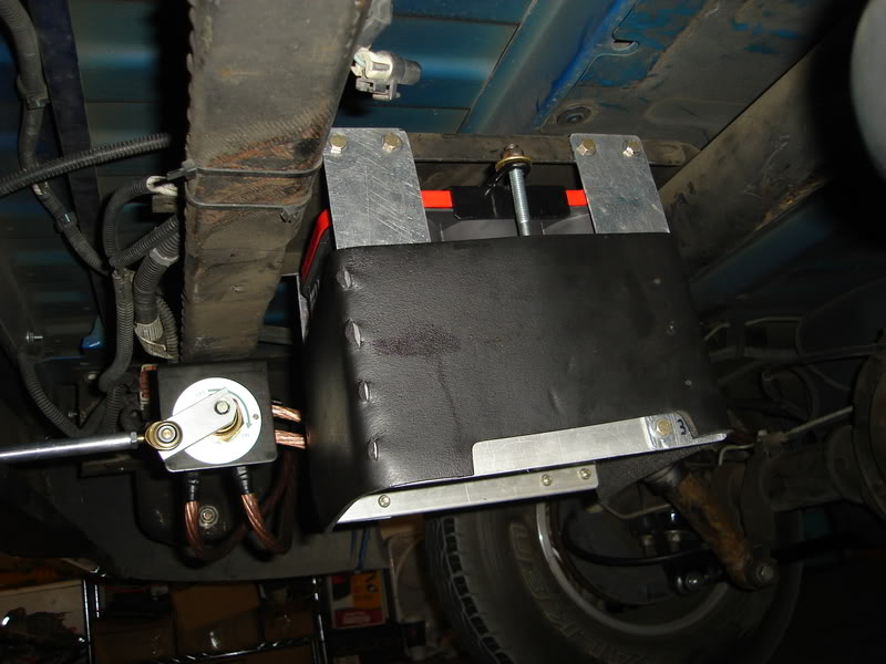

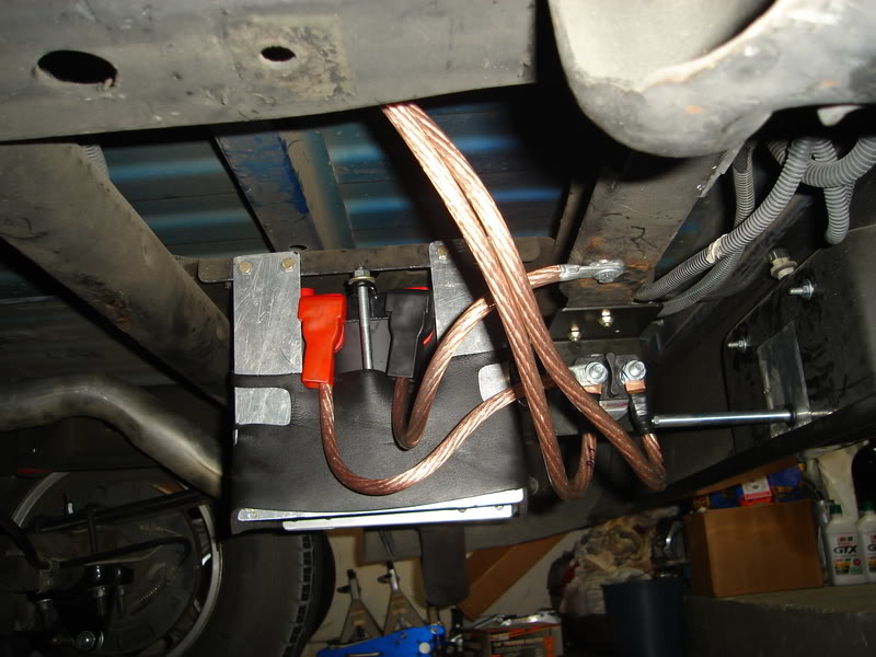

Default relocated the battery
to the back
Parts:
made a box/cradel with some scrap aluminum at work
250amp Summit cutoff switch
30ft of 2ga automotive wire ($1.88 per foot at advance auto)
battery hold down
2 side post adapters
2 15in 2ga wire with clamps

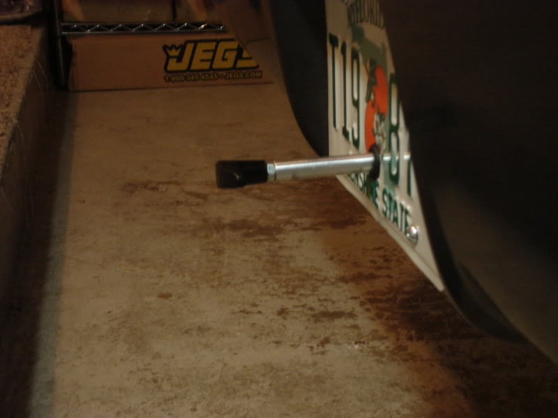

Originally Posted by trever1t
Looks good....are those wires insulated?
b4 the license plate pic you can see the writing on the insulation. That be a nasty mess if they weren't. Looks good to me! Be sure to spray those connections down with corrosion resistant goo.

Why is there 2 positives going to the battery? BTW it looks good. I plan to do that myself so thanks for posting the info.

Originally Posted by v8
Thats going to be a bitch to change when it goes out ahaaa
on the good side nice job and nice write up.
thanks kevin.
it shouldn't be too bad.
i had to put it on the jack to get it in place so i could bolt it in.
i just have to reverse the step to take it down.
i'll be sure to spray them down with some CPC from the Navy
instead of running both wires to the battery as per the diagram, i just ran the 2 wires to the same post on the cutoff switch, then ran 1 wire to the + battery side. is that what your talking about?

Right but I am asssuming that one is for the charging, however you are defeating the purpose of the safety switch. Why dont you just connect the alternator to the junction box under the hood and it will charge the battery so long as the switch is on. Just my .02

the purpose of this set up is not only to shut down the battery in case of emergency but also to shut down any feedback coming from the alternator. this is as per NHRA Regs.
