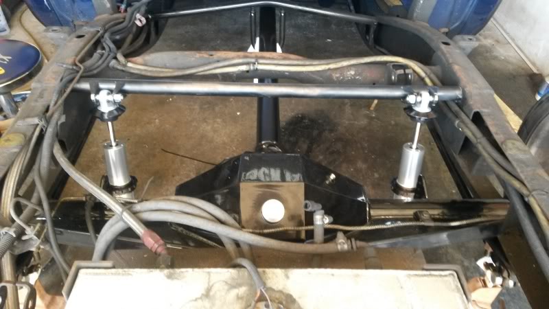

This Is how mine are setup
Old Apr 8, 2014 | 12:22 PM
  #26
heavychevy01's Avatar
Joined: Apr 2008
Posts: 69
Wanted to be able to change to coil springs possibly!
