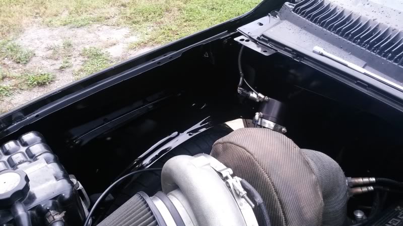

Weight reduction.
Front bumper is a cover over stock one. Stock one is chopped up to just hold cover.
Took front fenders off, and took out inner walls.
No rear seat.
Dash was removed all wiring was removed from entire truck. Entire truck I rewired from scratch and dashboard bracing was chopped up. And dash was reinstalled.
Entire AC system was removed.
Carpet padding removed and carpet reinstalled.
Front wall of bed was removed and billet aluminum replaced it.
Basically a lot of little things which add up.

This what inner fenders look like

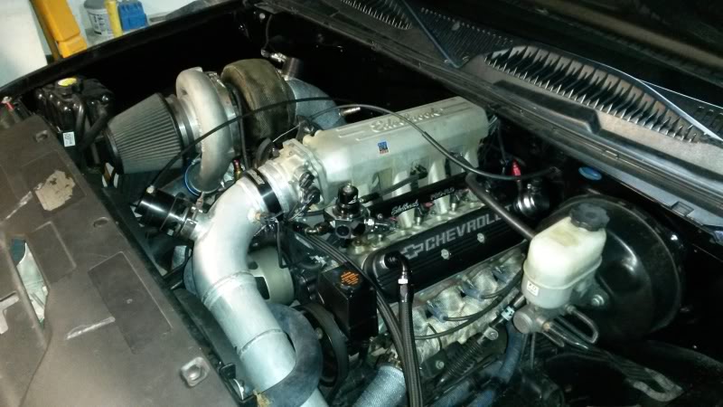

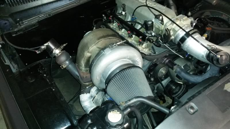

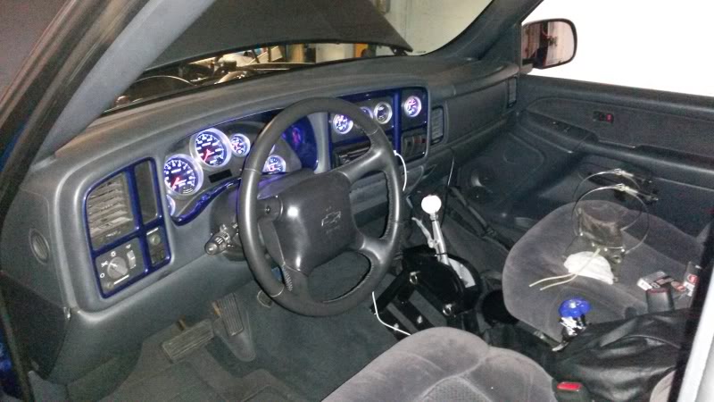

Who made your turbo kit? Looks like an s400 turbo?
And im really curious what you have going on with your wastegate...is that a position sensor?
