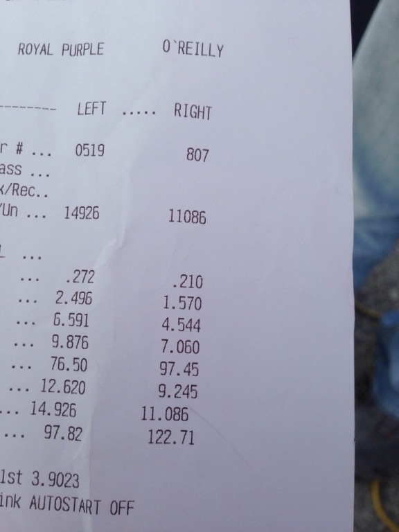

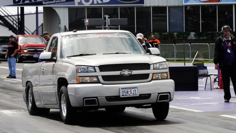

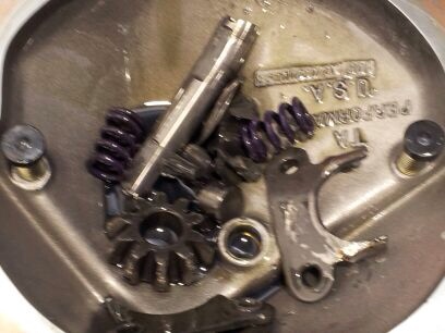

Went to HPT's Shoot out this past weekend and I had a blast. Even was awesome. I entered in the 11.0 index class and won first place. Ran a 11.08 @ 122.71 MPH. After I won the 11.0 index class I decided to mess with the truck a little to see if I could get that 10 sec slip but broke my differential. Posi blew up. Oh well, back to the drawing board. I will be doing some changes to the truck and hope that next time out I get what I've been wanting... 10 sec slip off of this mean *** 5.3. Here is the time slip and a picture of how it launched. Enjoy.

Time slip. Right side is my truck

Launch

Great run and an Awesome photo !!!!!!!!!!!! Diff coming apart sux. Are you changing that setup ?

Thanks. I'm only going to chance gear ratio and try a different stall converter and see if I can get it to click that 10 sec pass. If I can bring my 60's down a tad I know it will get me where I want to be but had a weak link in the diff and have out. I'm going with a full spool now and going from 5.38's to 4.88's. stall right now is a Circle D 5000 and now going with a Neal Chance 6400

Holy ****, that is still some serious gear and stall. Hopefully the suspension doesn't need a ton of tweaking after that change.

I'm also going with QA1 front coil overs dual adjustable. I will keep you posted on how it goes. Hope to have truck up and running in about 2 weeks.

Now its time to change you sig. And... Holy **** 7.06 in a 1/8th dammit man!
I just did :-). Thanks

Great pic. Love that truck it's a nasty little ride. Holy **** stall on the way lol wow. Go get that 10.

yeah yeah yeah rub it in buddy lol!! she was running very well, sux the differential went though at lease you were able to take the 11:0 index, if i woud have entered it would have been one helluva shoot out at the end
