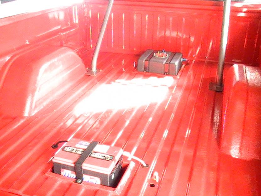

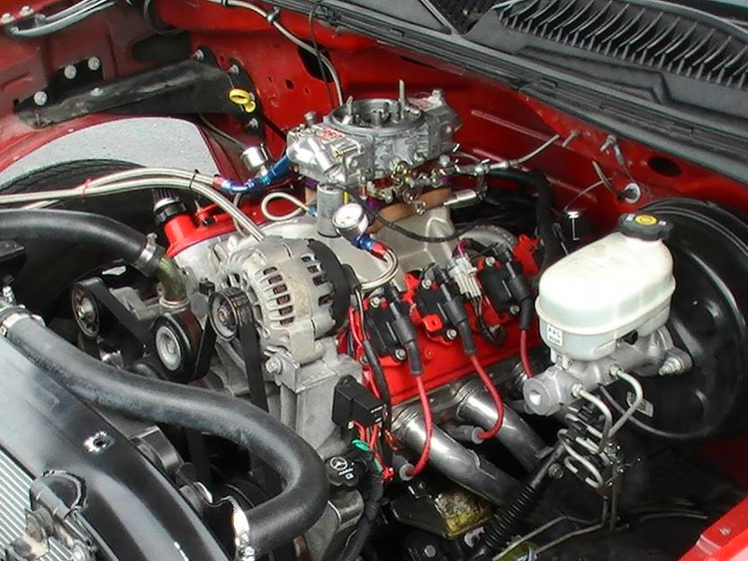

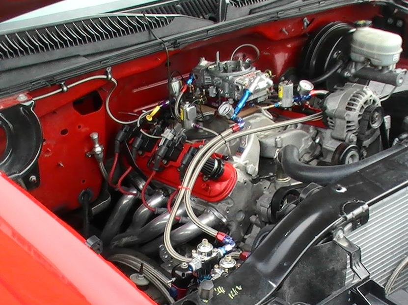

No sway bar,computer,harness inner fenders AC,heater core, heater hoses,etc. Nothing under the hood but motor. Nothing in cab but dash, roll bar, 1 seat and harness,shifter,nitrous bottle.No gm fuel tank.no leaf springs,tail gate. I'm sure I've missed a lot,but I can't remember. It's a case of OLD TIMERS. Now I just have to lose 100 lbs and that would really help. Heres a few pics, can't find the ones of the inside.

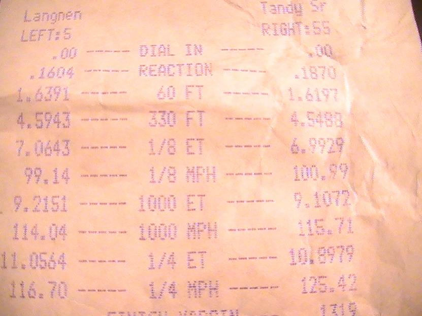

Just got back from the track, Ran a 10.89 @ 125.42. on a 200 shot. 70% off the line and the rest in at 1.5 seconds. Spun just a bit but really launched well. Messed with the timing also. This was the last day they will be open untill spring. Hopefully will get front coilovers during this winter and maybe with some better weight transfer I can gain a little more.
