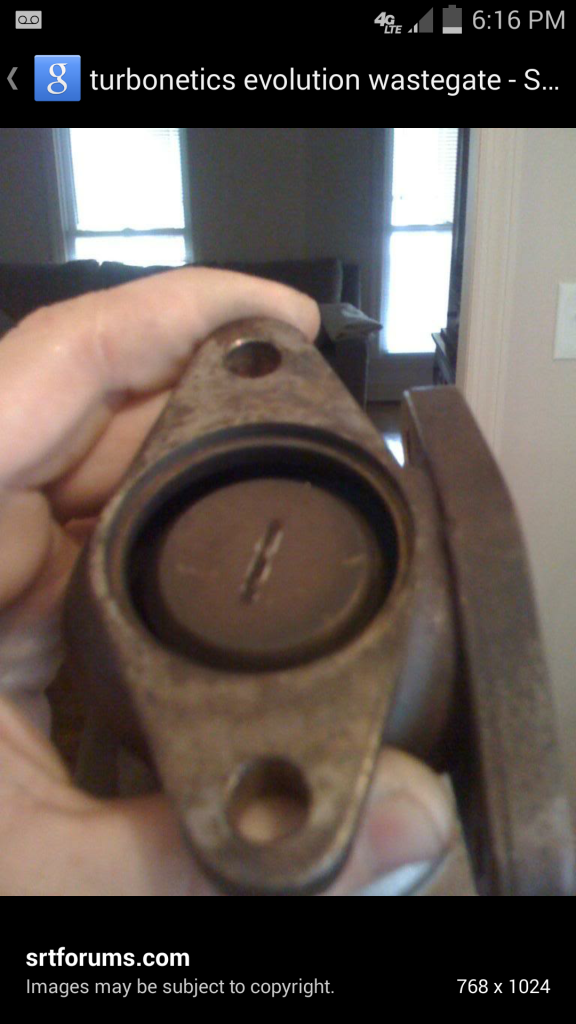

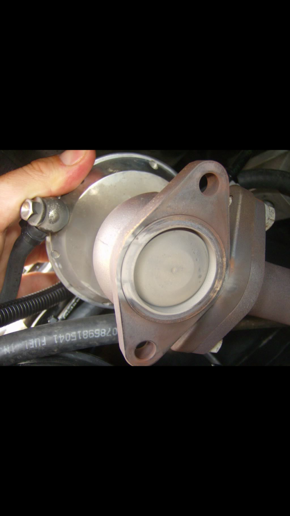

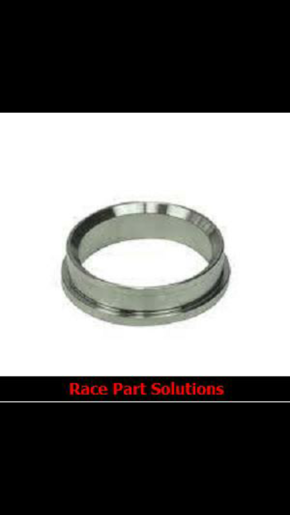

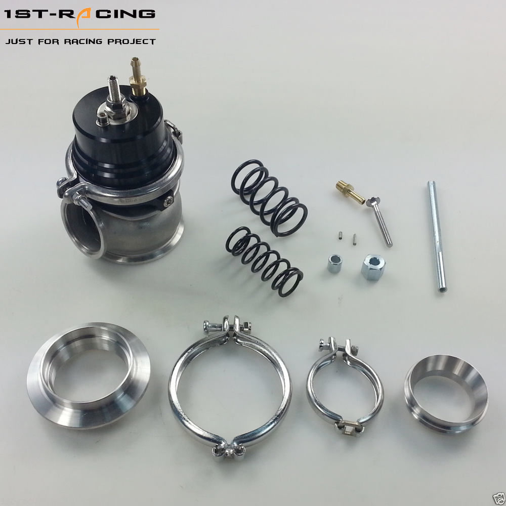

This is basically the same wastegate I have. Mine came with 4 springs which I have no idea what they are. Looks like the fire ring is built into the flange on mine?
Old Jun 20, 2014 | 06:12 PM
kelsey_canard's Avatar
Joined: Nov 2010
Posts: 959
From: Arkansas
Now that I think of it I may check my flex pipe in my crossover. A leak on my hotside would make sense for a lot of things. Im just using a regular flex pipe from the exhaust shop
