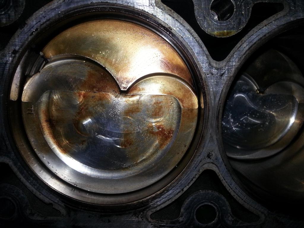

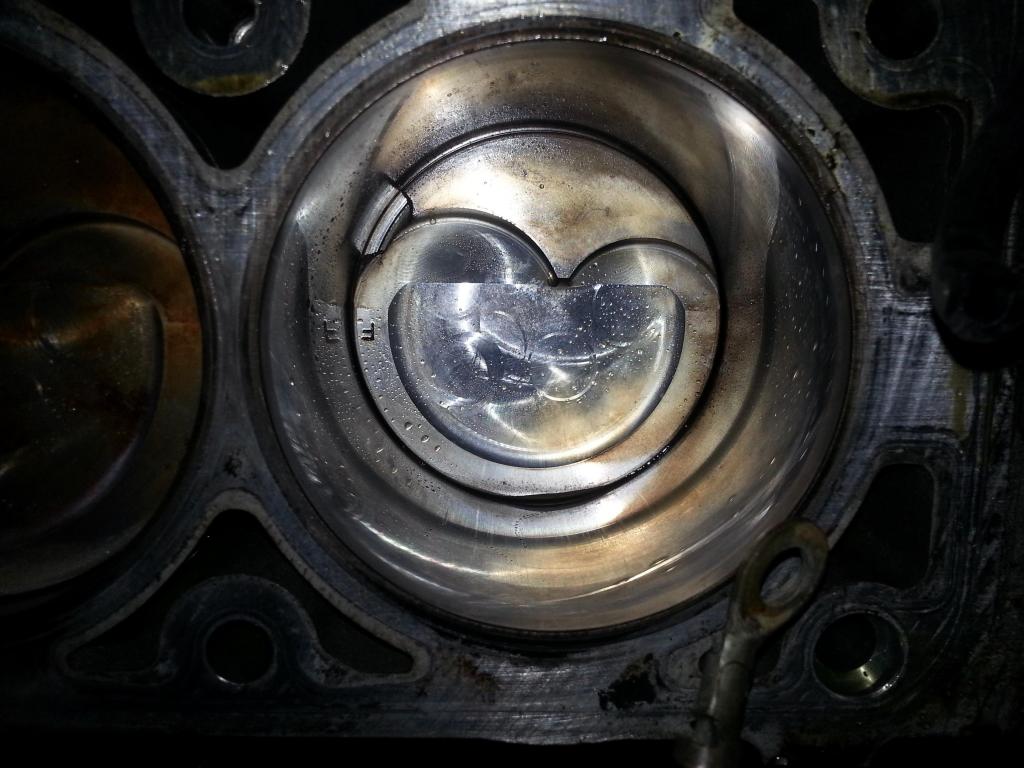

Wow thats bad news. Sorry to hear. Any pics of the damage?

Thx. Really bummed about this one!!

On a side note those internals are clean!!!

Yeah I was surprised for 14k on the motor. But of course, I suspect the shinny one was getting water for a month so that cleaned it up quite a bit.
TSP found my file and can sell me new pistons, but they only come in a pack of 4 from Diamond. Thinking of just replacing them all at that point. I need to pull and strip the block to look for cracks.
