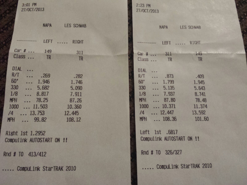

Well took the truck out to see what it would run on the last race day of the year here locally. Firebird Raceway boise Idaho. Temps around 65 degrees at 2700ft elevation. Truck is a 07 classic ccsb 4x4 with a 3/4 drop weighing roughly 5000-5100lbs race weight. Mods are tsp220 cam, pacesetter 1 3/4 headers/ory, magnaflow 3.5 inch exhaust, k@n fipk, 91 octane mild street tune, nx proton kit 125 shot.
Truck felt great, especially out of the hole. That big ol beast was rocking mid 1.7 60ft squeezing right out of the hole and it felt great. I was very happy with the runs and cant wait till next year to throw a 200 shot at it and get my 11 second pass. Anyways here is the slips. Pretty consistant also.

Good stuff! I wouldn't be too cocky about running 11s on a 200 shot. It is a very good chance but the math of 100 hp or nitrous dropping a second, doesn't always add up. Another 75 of juice should get you very close and possibly make it.
Your slip means much more then anything(in my eyes) but you should check your corrected time. I would guess it is almost 12.00. 2700 ft is not a good DA but the cool weather and nitrous help make up for some of that.
Your DA was 4293!!!!! Your corrected was high 11s to 12.1. so much for the cooler weather making up for the high physical elevation! The nitrous did help some though! IT is nice to have your 02 in a bottle that high up.
