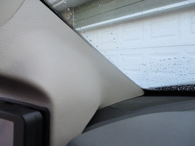

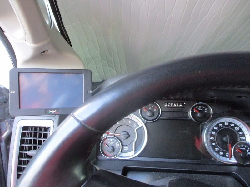

managed to find a brand new Edge CTS mount (38405) on that electronic auction place for $96 to my door (crazy how that's a $20-30 savings when just a couple years ago, these were $65 retail). ordered on Memorial Day & got it this evening.
install took about a half hour... including 15min of fumbling around in no hurry whatsoever. the hardest part was getting the mounting screw aligned & threaded, but once i did, it fit just fine.
the bottom edge doesn't quite tuck in all the way behind the dash & sticks up a tiny bit in the corner by the windshield... but it ain't bad enough to bother me. at least now i ain't gotta fold back 6" of my sunshade no more like i had to with the suction cup mount.
after a couple test fits, the CTS2 adapter was a bit too tight against the back of the MM3 (or Smarty Touch) to properly fit into the rubber grommet's retaining ridges, so i went with the CTS3 adapter & accepted it sticking out 1/2". from the driver's seat, you can't really tell much difference. i notched out a slot the width of the USB connector and didn't need to cut the grommet at all.
and for the more visually-inclined:

That looks good, I still have mine on the suction cup. I need to get a better mounting option like you did.
