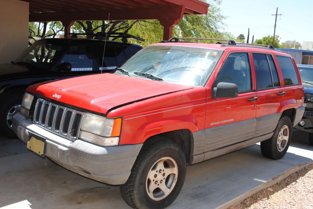

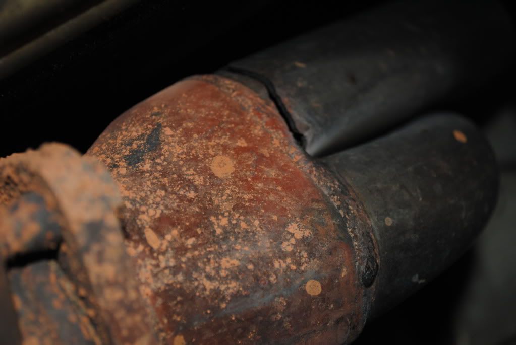

Well I got the Jeep. Bought a new battery and it started right up, but had a crazy exhaust leak. Turns out that one of the tubes right before the primary was split all the way through. Replaced it with the new redesigned manifold. Changed the spark plugs, wires, Oil, oil/air filters, and flushed the brake system. Passed emissions and registered. Getting about 16.4 MPG on regular gas. Insurance is only 15 a month. So with the amount I drive, the Jeep will pay for itself in about a year with the savings.
And the hood does close all of the way. I just have it popped open

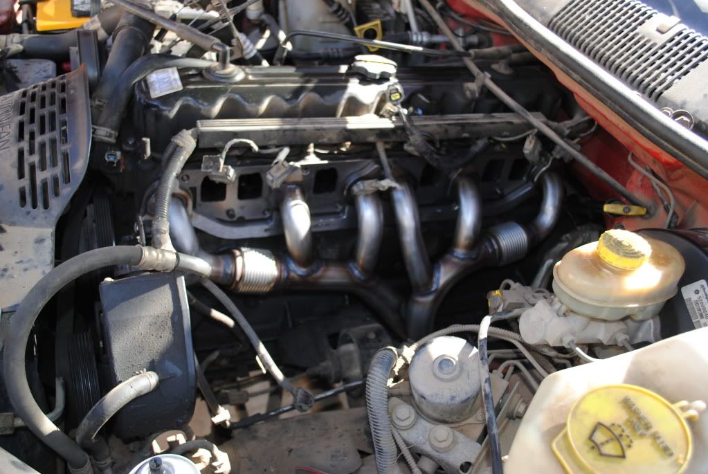

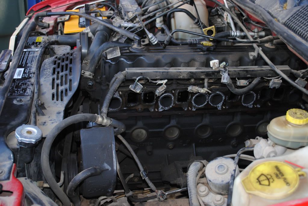

In 99 Jeep redesigned the intake manifold due to emmisions. The redesigned intake allowes for better flow, resulting in about a 15 hp increase. Here is my write up of the install.
Started with this
replaced it with this
spent 3 days soaking/cleaning/painting it
installed
how i routed some of the hoses. The hose that crosses in front of the tb broke last week when I did the injector swap. Used some 5/16 rubber hose to reconnect it.
all done.
total time... 2.5 hours. would have been faster if I did it during the day but its around 110 here now so I'll do my modding at night if I can.
Driving impressions: It doesnt studder when accelerating. Befor I would have to put the gear selector in 1st to do a burnout, now it will roast em in drive. And I went from 16 mpg to 17.6 with the new manifold and EV6 injectors I'm getting 17.5 all city.
