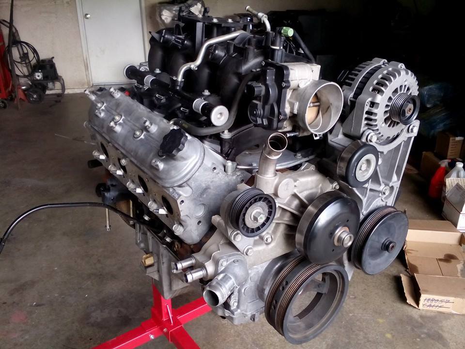

it's still not 100% perfect, but much cleaner now. Degreased and pressure washed it. Almost time to start changing some parts

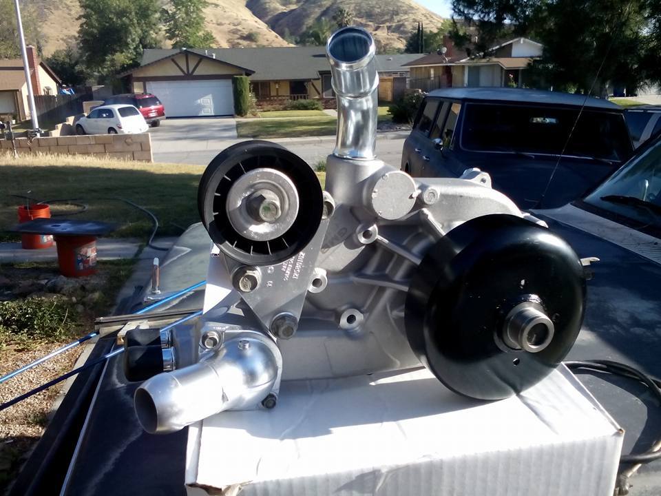

New water pump to replace the old original one i accidentally broke. lol

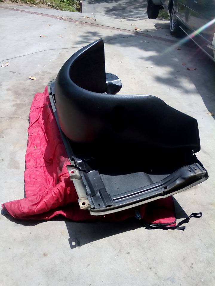

Coating the SloshTubz with some rattle can spray on bed liner as well while I have it apart

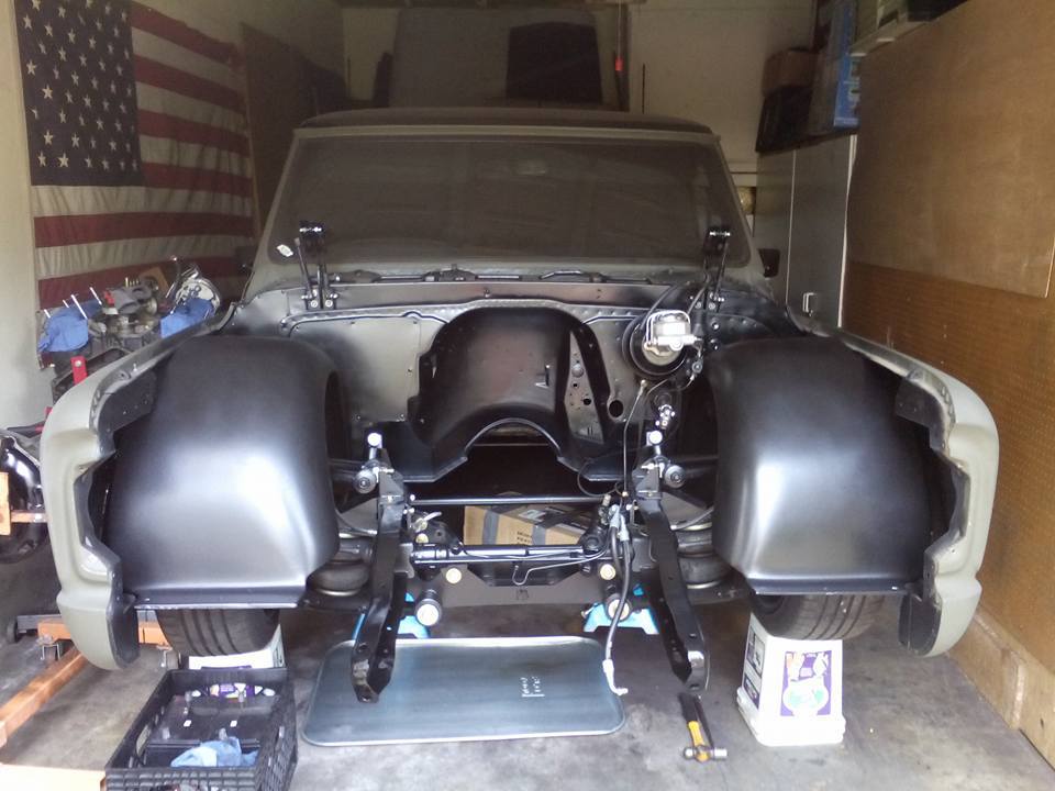

got the other fender off, and finished painting the firewall and stuff

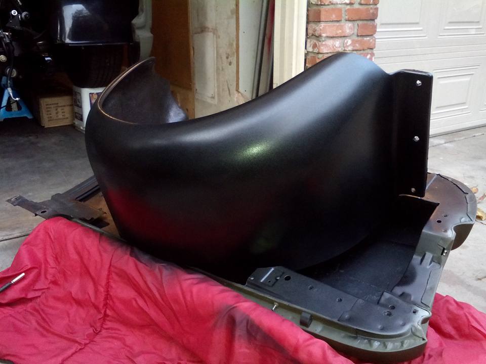

got the other SloshTub coated in bed liner as well

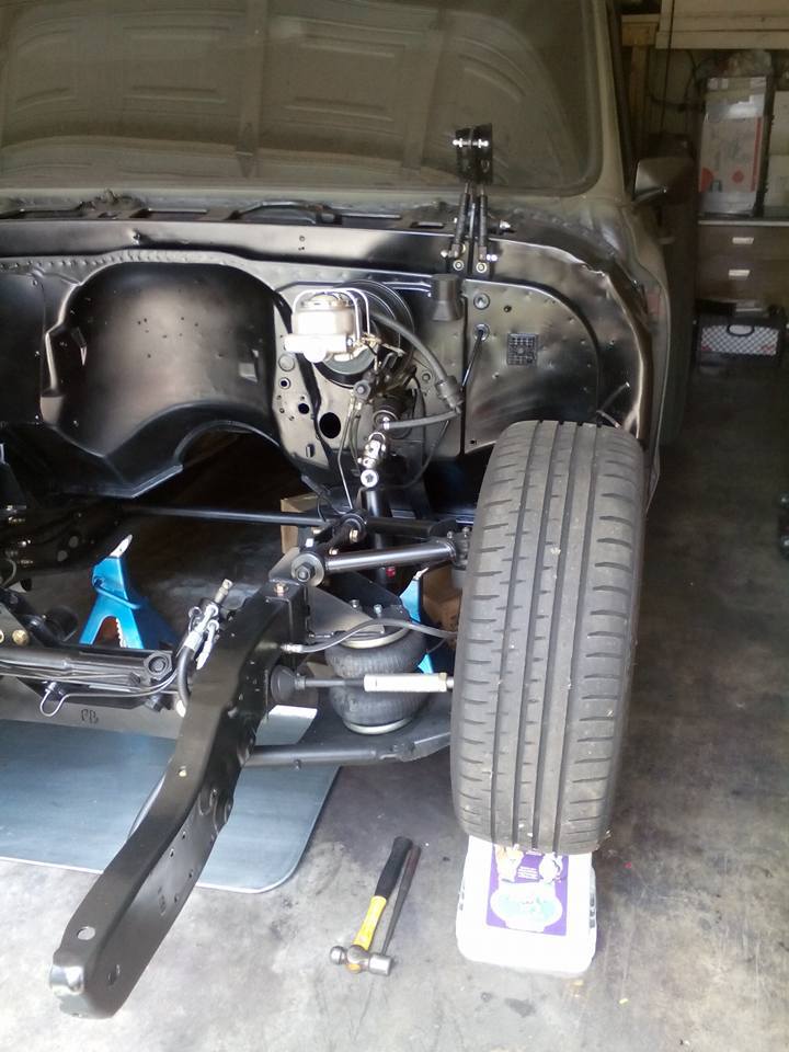

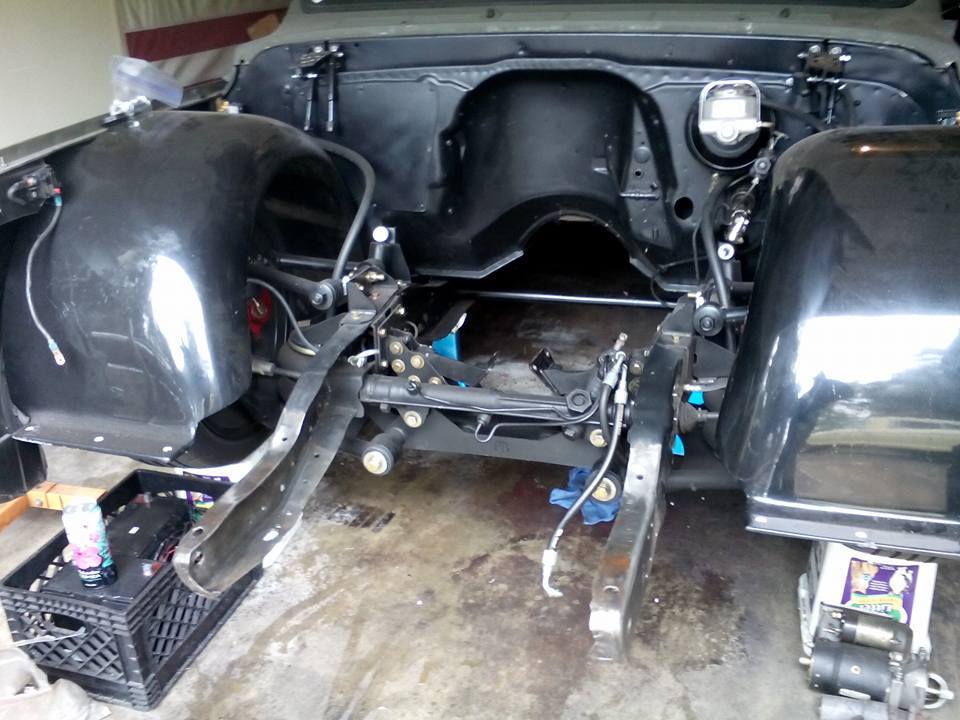

And back on. Now I gotta make a make a block off plate for the clutch linkage hole, remount the air ride valve somewhere else, remove the old fuel line, and do a few other things. Then it will be ready to drop the 5.3 in once that's ready

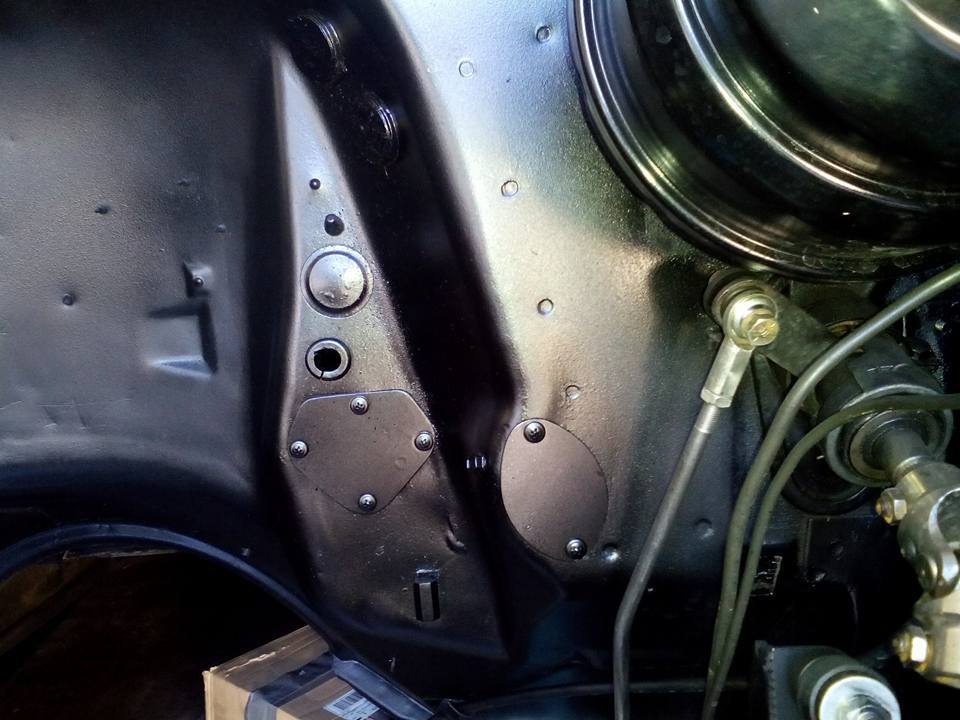

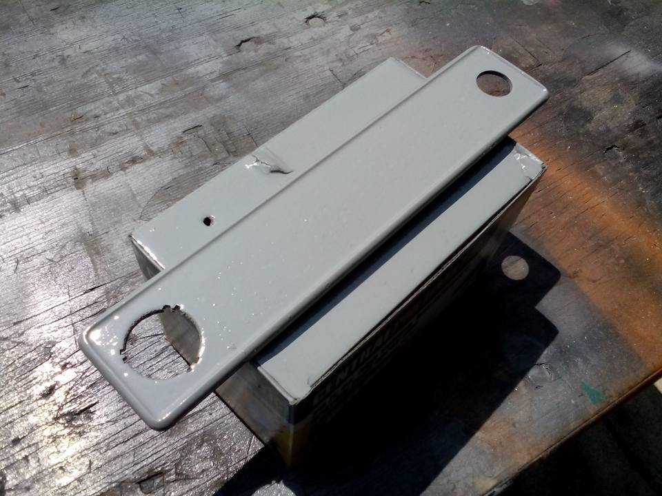

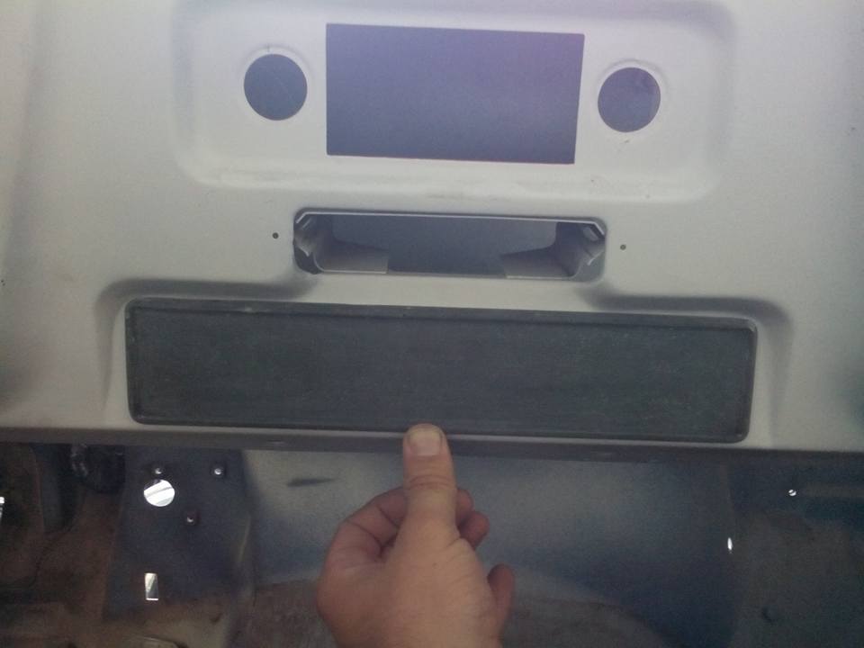

Clutch pedal linkage hole cover, and accelerator pedal rod hole cover made, painted, and installed

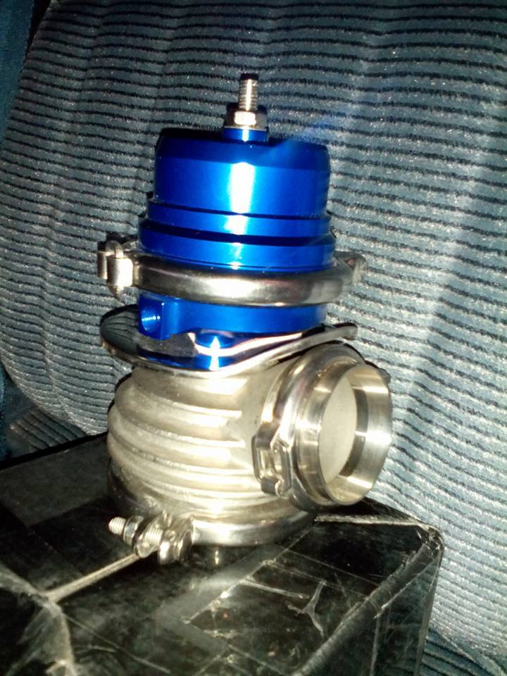

Big *** waste gate came in for the future turbo setup.

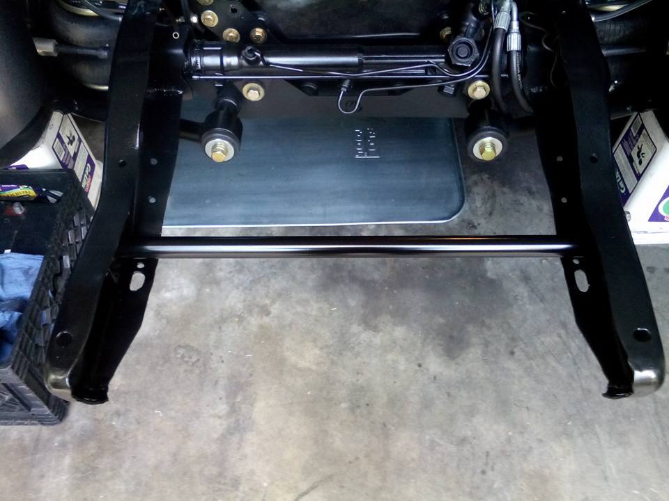

Front frame/core support cross member painted and halfway installed. Just need some nuts and bolts, then I can bolt it, and the core support frame mounts back on

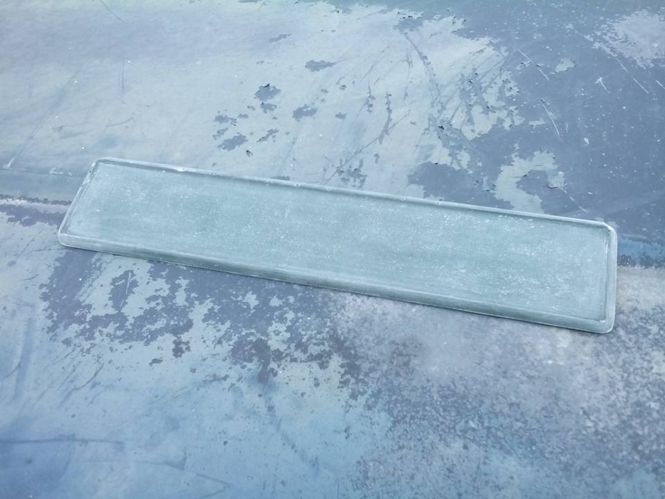

Making custom truck parts... got the tools made to make the molds for the final products. These are standard size radio delete plate molds/tools, and a couple of custom ones being made. Not pictured/made yet, is a double DIN one for when I put a dvd/cd/radio in. The long one will be used to hold some extra gauges (once I go turbo), a dual usb charging port/cig lighter, and the ignition switch. The standard size one im not using. These are being made out of fiberglass, and are nice and thick/strong

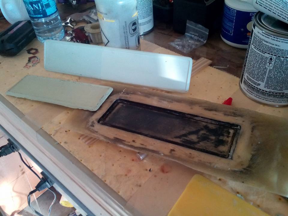

Tool made for custom gauge/ignition/cig lighter/usb charging port, mounting panel

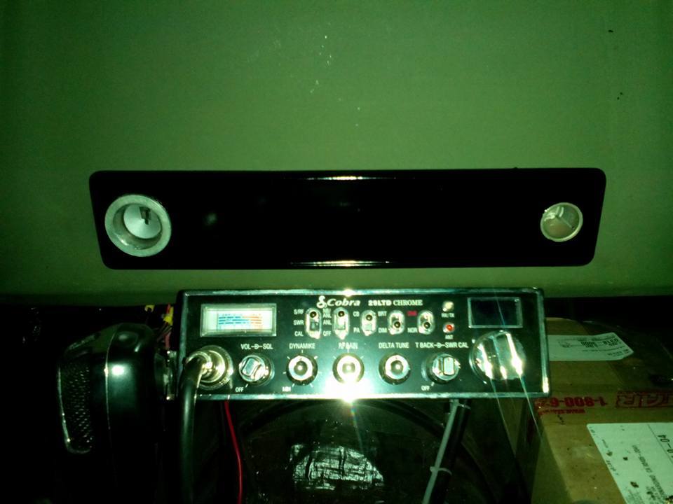

fits where the stock heater controls, ignition, and cig lighter on a stock dash goes too. but mine is a flat surface in this area

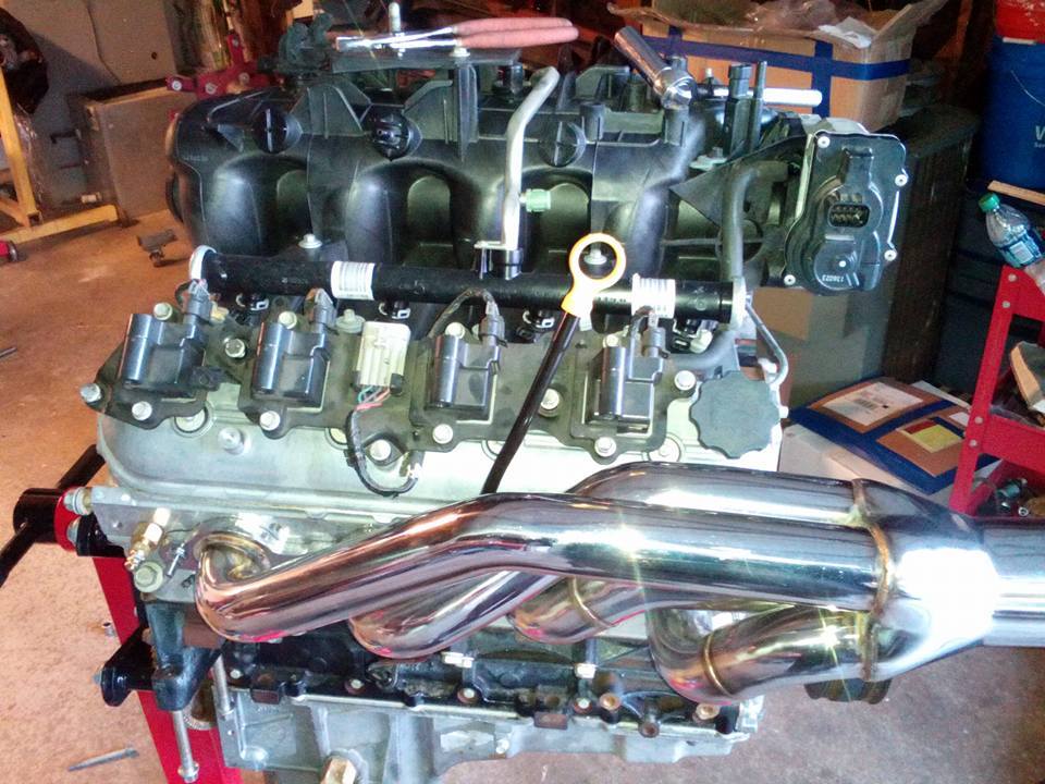

Doing some mock up if a few things so I can figure some stuff out. Got the f-body dip stick tube bent to clear the headers... but looks like I'm gonna have to do something about the coil packs because the front ones shoots the spark plug wires into the header tubes. Guess I'll have to make some new brackets or something to move them around to somewhere else so the wires will clear the headers

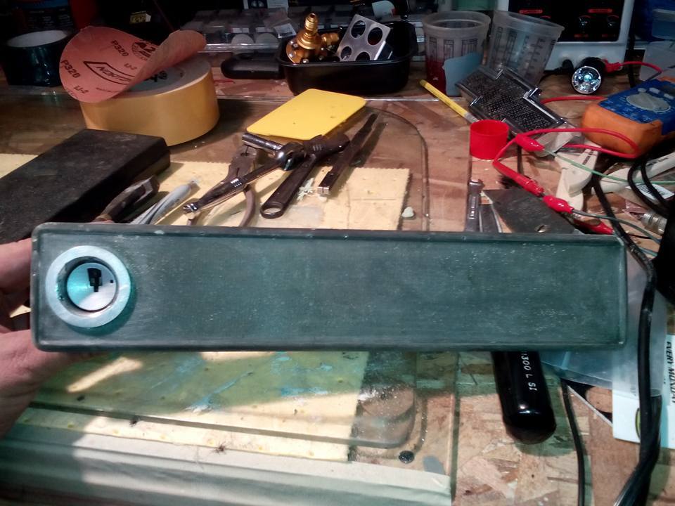

Ignition switch hole cut, ignition modified, and gonna do the cig lighter/usb one next, as well as epoxying on some mounting studs
