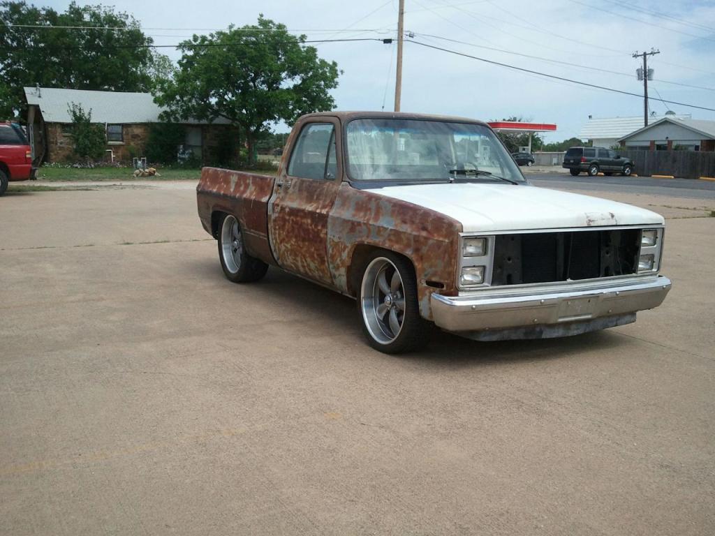

22 inch Coy wheels with 265/35 in the front, 305/40 in the rear, 5/7 djm drop with flip kit
