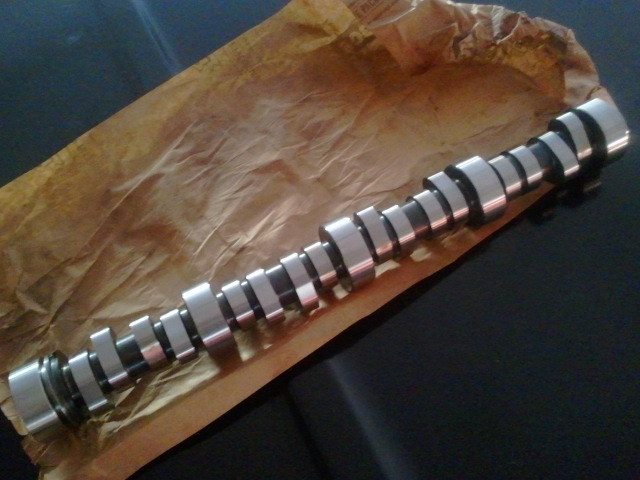

So i just got back from RIMPAC and started getting some parts together. I have some valve train noise that i am not happy with while idling
So i ordered some parts.
LS2 Timing Chain
LS6 Valve Springs
LS6 Cam
LS6 oil pump
innovate MTX-L wideband
Hp Tuners
corvette servo
And some others i can remember
Not looking to go crazy but i feel that this should be a nice little little boost in the power band for my projects goals. i plan to get most everything in the valvetrain cryo treated since i will be driving this in higher rpms a lot. this build will be slow as i am gone a lot for work, but in between the family and work i will get some pictures in there for you guys.

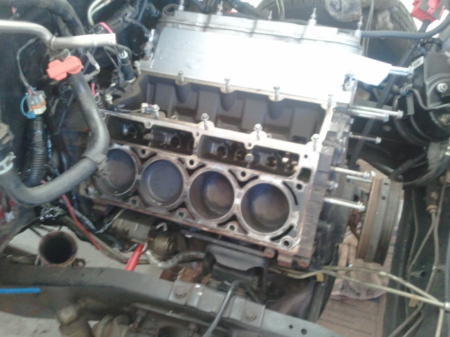

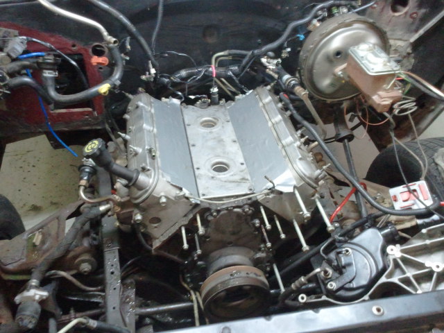

Well i just got back a couple weeks ago and am fixing to head out again in a couple weeks. Thought i would get a little more done on the truck. Got the ls6 cam and my related parts. The LS6 has a .050 smaller base circle so i figure i will need a .025 longer pushrod. I was going to get the heads checked out anyways while i had them off so i am going to get the heads milled .025 to keep from having to buy new pushrods. I will get the pushrods cryo treated to ensure they are strong enough.
In between work and the kids i managed to get out and get the motor torn down. Here is some pics for you picture guys. Gotta find a 3 jaw puller for the balancer. i am still rocking my Gen 1 tools so my balancer puller is a bolt on. gotta get with the times. it seems that i am buying a whole new tool set with this motor....

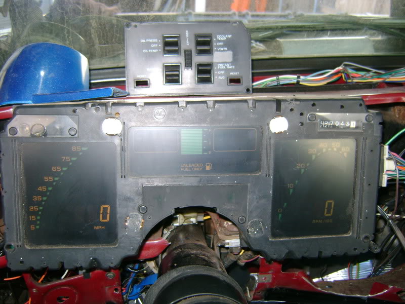

I am at work but i can get some pics up whe i get home. I cut the metal dash out and put the digtal dash in its place. Pretty easy i have a wiring diagram somewhere i can post up. I had my battery cutout on when i was adding my tach and wideband in and a 12v line grounded out to the digital dash and a lot of smoke came out......so now i am running a 98 z28 cluster all electric with a 150mph speedo. Good luck. Hope to see you out on an autox track

I thought i had more of this dash before i swapped it out for the f-body one. i will keep looking though.
roughed in mounting.
