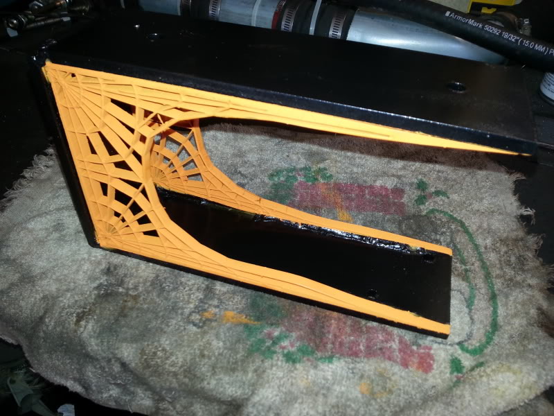

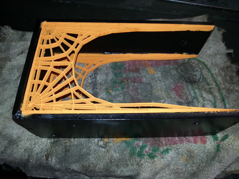

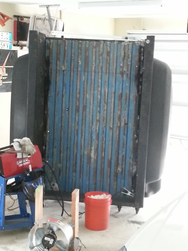

Added a little weight to the bed. So nice to not have a piece of pkywood as a bed floor. Gotta finish welding and then seam seal this then I bolt it on and see how it looks.

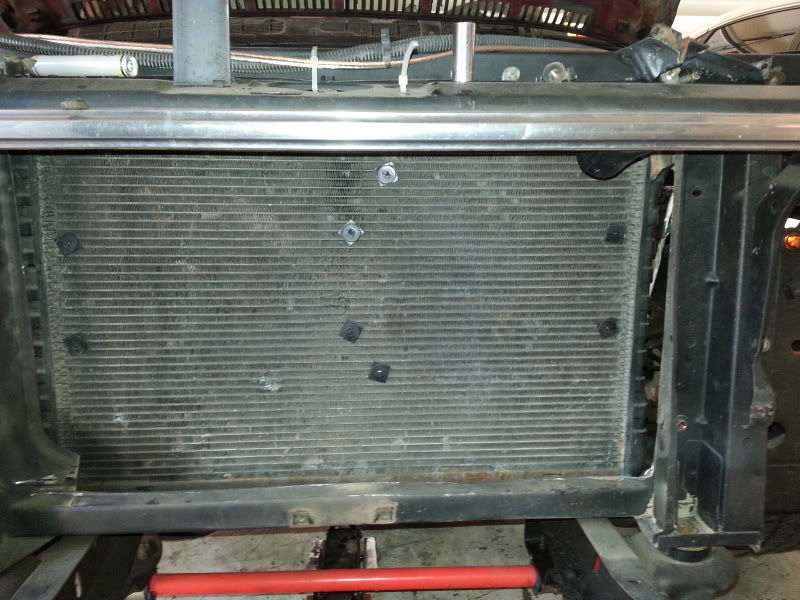

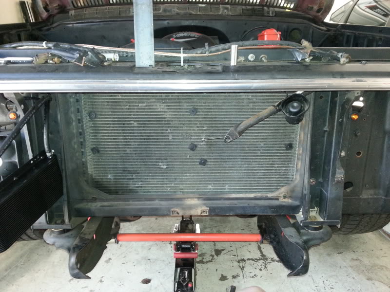

So I got a few minutes without the kids and I started my radiator ducting/ heat extractor hood project. I am cutting the core support a little bigger so I can lay the radiator forward some. The I will duct it from the grille opening and up through the hood vent. Might be stupid but from what I read it should help cooling and give me some much needed downward pressure on the nose at highway speeds. Pics below. Flame suit on.
Before.
After

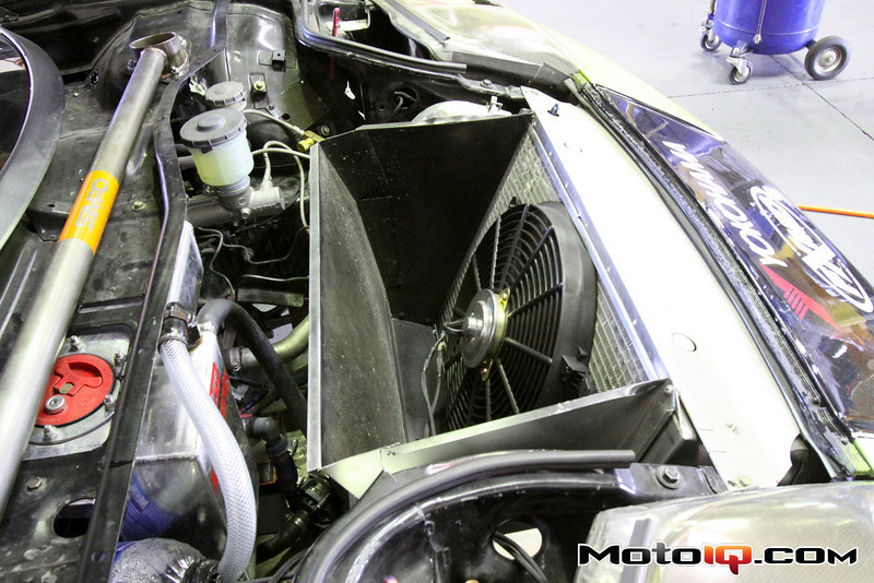

Got the right side cut out before kids begged for ice cream. I will do the rest one night after work. Heres a pic of a rough idea of the hood vent.
