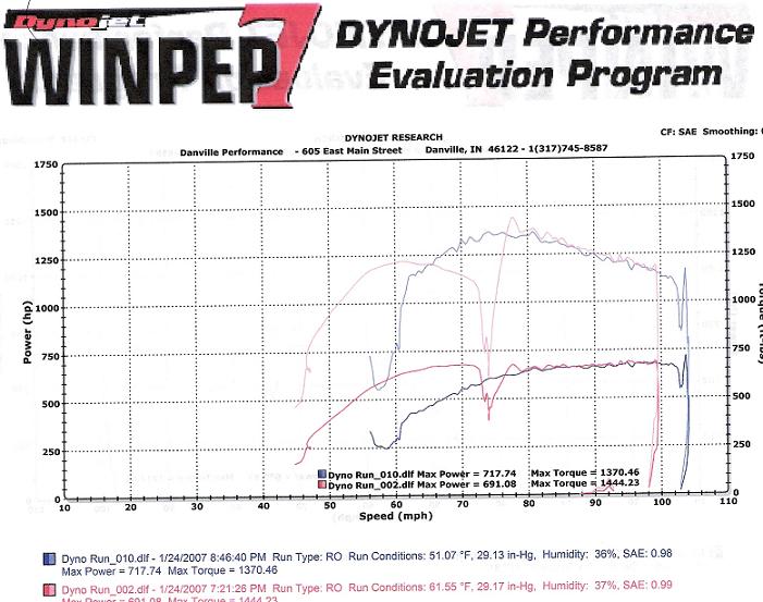

Well we think so anyways! 691hp/1444tq backed up with a 717HP/1370Ftlbs at the wheels!
Attached Thumbnails Most powerful LBZ fuel only truck in World!-717-1370dnload.jpg

SWEET!, a little deceiving though since the 717hp# and 1444tq numbers were spikes, but still killer numbers!!

Wouldn't those spikes be where the shift was. That wasn't RPM on the bottom it was MPH. What mods are done to it?

Stock motor and injectors, headstuds, A5K, ATS Dual CP3's, exhaust, Cai, Duramaximizer, twin lifts, custom programming from PPE with input from MCRat and us. LBZ is too new and we can keep it from shifting. Yes there is a spike but look at how flat the power curve is.
