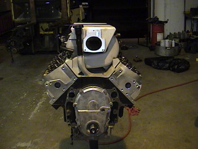

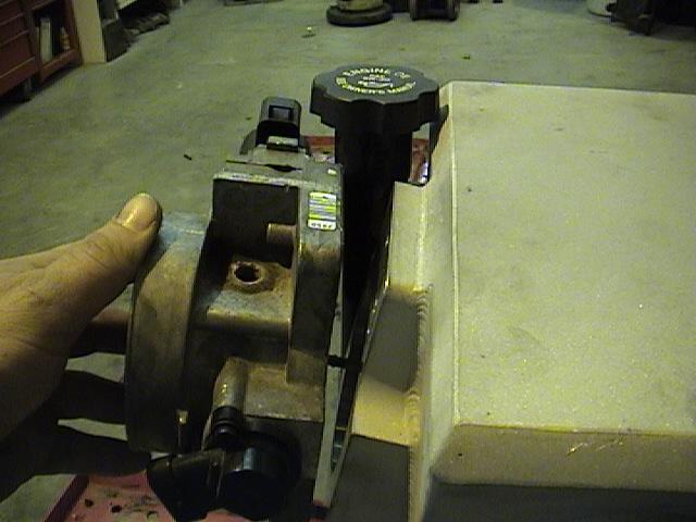

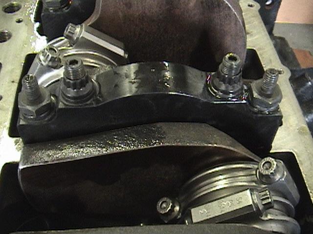

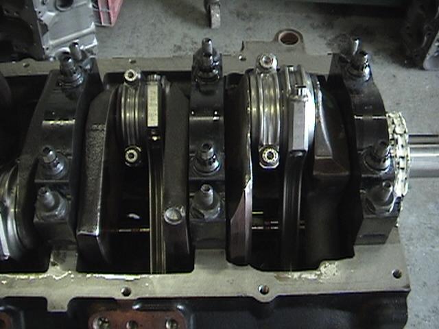

I finely got my from engine from the machine shop after being held up on a timing chain for 3 weeks. It seems that some of the people at Cloyes didn't know they made double roller chains for the 8.1 until we got the part number from Rarlar. Now the chain is hitting the cam sensor. Also the throttle body will no fit on the intake it hits the oil fill tube. You can also can see the billet main caps. The inner studs are for a cummins turbo diesel.

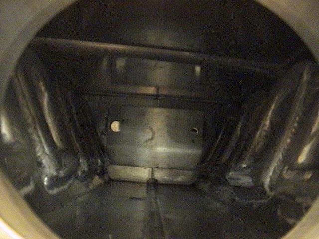

who built that intake. it looks really nice

maybe a throttle body spacer will help clear the fill-tube?

Good idea, I have a Airade one floating around.
Hopefully someone will come out with a 90mm throttle body soon.
