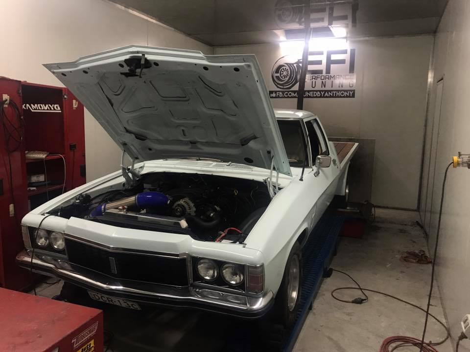

The guy has another engine that came out of a speed boat, can he put those heads on the truck block? would it make a big difference if he used those heads and got it ported and installed a cam?
I attatched a pic of the ute
cheers for the help
