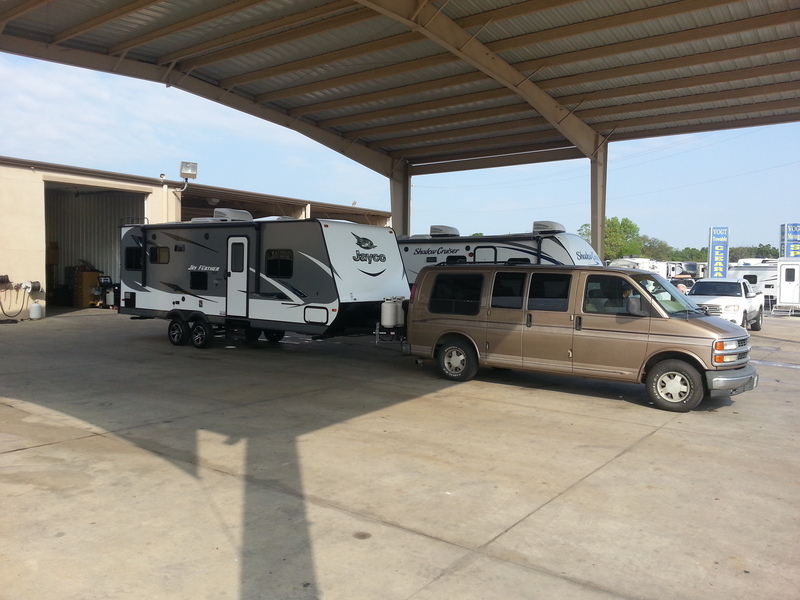

If you are over 5,000 ft elevation it is possible that it is giving all it has in stock form. That being said I am towing 6,000 lbs with a rig that is grossing over 12,000 lbs with the little old 5.7 Vortec. I have the same 4L80E transmission and 14-bolt you have with the same 3.73 gears. The 350 is not stock but I feel you still have more torque in the low-midrange than I do. I tow in 3rd gear and let it downshift to 2nd on its own with Tow/Haul. At 65 mph I let it eat until about 3/4 throttle before the shift tables force a downshift. At about 4,000-4,500 rpm the little 350 has no issues holding speed on long grades.
This is my tow rig and trailer
I will admit the 5.7 moves my Express better than someone would expect. Its basically a 300 HP marine 350 with some headwork, ported intake manifold, and headers in place of the marine manifolds or a Ramjet 350 with headwork and a ported marine intake. Probably makes 340 HP and 420 ft/lbs. Unloaded it has some punch for something that weighs 6,000 lbs and has a small block/4L80E driveline.
