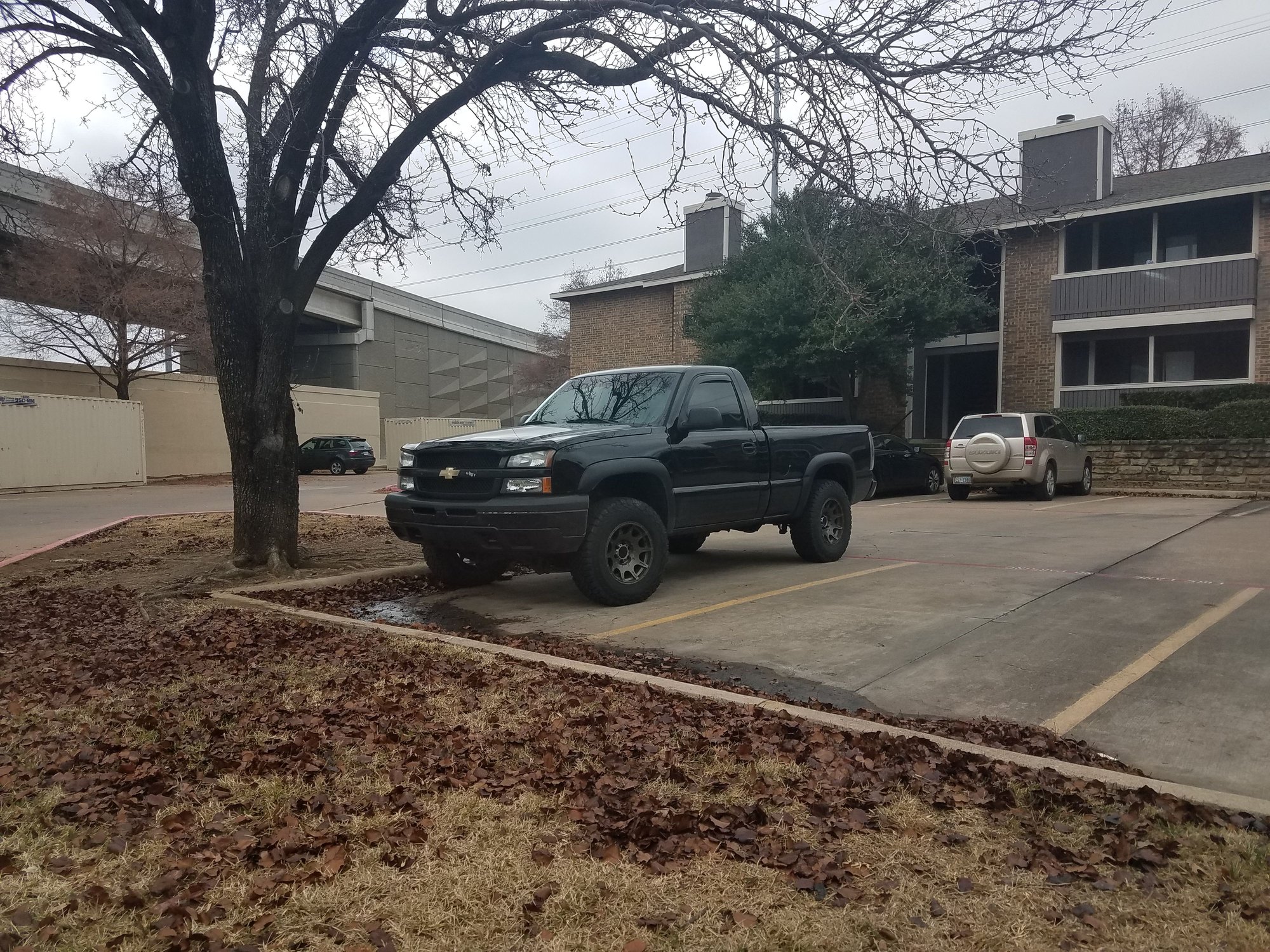

I am thinking of changing up my rear suspension by swapping to a set of Deaver leaf Springs and bypass shocks. I am trying to figure out how much lift I currently have.
The current set up is stock leafs and shackle with NO block, fabtech add a leaf, off road design ladder bar and billstien 5100s that are a little to stiff.
After talking to Deaver today I tossed the idea of spring under and I think I may go with a set of their 4in lift Springs. I don't think my truck is lifted 4in more like maybe 2in. So I figured I would also order a longer set of shackles that would drop the height and give more articulation.
I measured the height of my truck from ground to middle of the wheel well and here are my measurements. On slightly sloped towards driver side parking lot. I also have 285/70/17s
(39.5 passenger rear) (38.2 driver rear)
(39.5passenger front) (38.5 driver front)
Anybody with a bone stock truck have ride height measurements handy? Or mind taking them?

I will run out at half time and grab mine if I can help. I'm not stock but the only changes are; 3 inch block in place of factory 2 inch and 305/65/17 BFG's in place of the the OE Firestone 265/75/16's. Should be able to get ballpark. Hell when I bought the truck new back in '01, I almost walked out on the dealer because he didn't want to put Wrangler ATS 285's on. Told him it was bullshit that a 32k Z-71 truck came with rinky dink street tires.

May not help but I came up with 37 3/4" on both sides. Tried to put a straight edge on the tire to measure height but got a little complicated trying to hold straight edge, tape measure and flashlight app all at the same time. Tire was roughly 31 1/4" which seems small for even BFG. Normally run 35lbs in rear tires when not towing or hauling but it's been sitting for way too long. I'll check tire pressures tomorrow and report back. Also bear in mind that I have a ECSB with a sub box, a toolbox 1/4 way full of **** and I'm sure some other **** to add extra weight.

Btw the front measurements were 37 3/4" passenger and a whopping 38 5/8" driver side!
When I changed keys and blocks I set the ride height by parking the truck in the middle of a 22' deep x 28' wide garage supposedly poured to drain from a box set in the center and putting a 2' level on the door sills. Both sides were then leveled according to the level.

Wow that surprises me alot! I didnt think my truck was lifted that much but its so hard to tell just by eyeing it.
Strange your driver side is higher usually I hear people say the driver side sags because of the weight of the driver and gas tank all the time.

I'm disappointed. I thought it was a little higher. The truck is sitting on fairly level ground that probably slants everything towards passenger side rear. I'll check tire pressures tomorrow in daylight and without beer goggles (maybe). The driver front being that high has me a little bumfuzzled because I checked the ride height after I changed keys, realignment, then changed arms and realignment. But right now she's sitting where the rollback dropped her 6 months ago. I've got to get my *** in gear!
