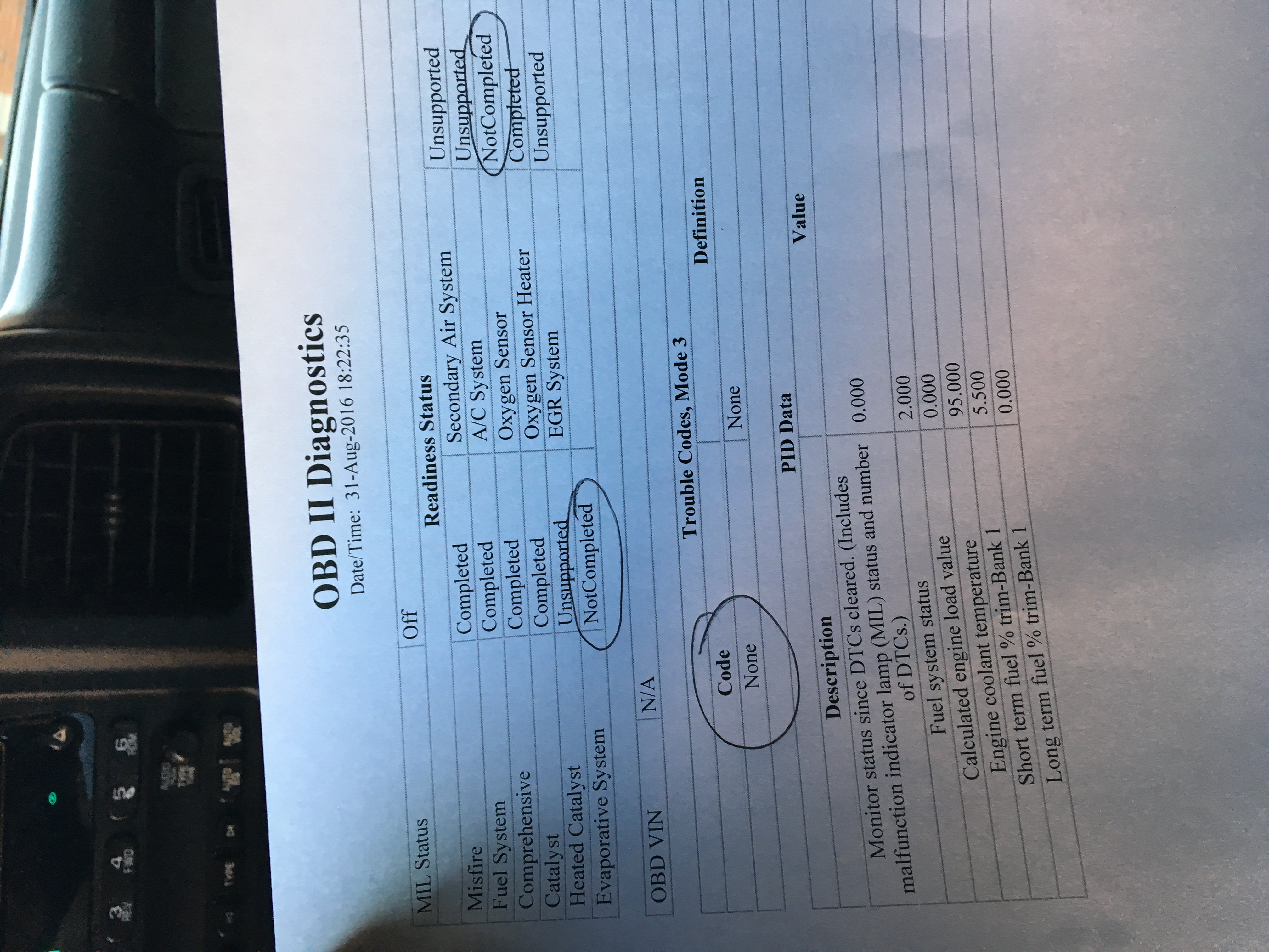

Failed emission yesterday say drive cycle evaporated system and oxygen sensor not completely. What we can do? I haven't drive about one week. It been pass emission for 10 years. After turbo and tuned installed start fail emission. No cel

These are the readiness indicators. In GA, you can only have 1 readiness test that is not ready and still pass. If you have 2, then you failed (as you stated).
You have to complete a drive cycle. Link is below:
General Motors Driving Cycle
After you complete the drive cycle, take it back to the same testing station and ask him to do a "readiness check". It shouldn't cost a thing and it will tell you which readiness tests are green (ready) or red (not ready). If you have only 1 that is "not ready", then you will pass and ask him to retest it (free for a retest).
Yeah need drive more that right?

My guess is not a lack of driving but that not all codes were properly turned off after the new tune. Check back with your tuner to make sure they are all off.
I think when you haven't driven enough none of the readiness tests will read complete. Once you turn off ALL the codes for your O2 sensors you will not have a SES light and you will pass the O2 readiness test and be on your merry way.
