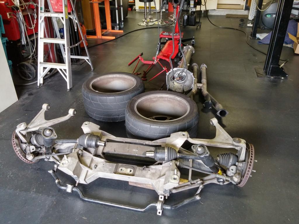

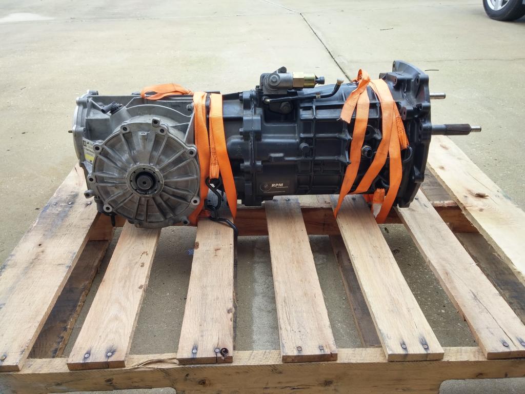

Well, clutch wouldn't hold new power so back apart again...fricken torture. I bought a Monster Twin and now sending my tranny\diff to RPM for a tune up. They have been in for 6-7 years. I found some metal in the diff fluid.

Well...6 months of BS and I finally found the problem with my Trans. My servo broke the clip and cracked the second gear servo piston. With that, it ate up my bands and my Z-pac and scarred up the case pretty bad. Fast forward to this weekend and I just have to button up the exhaust and x-member and back on the road. I sure hope this is the fix.
Also found my TC was coming loose again with red loc-tight. I cleaned all threads and loaded it up again with red and torqued to 50 lbs. I guess I will check before every track run. I just don't get the loose TC. My motor is too smooth to be an out of balance problem !!
It is too hot here for the track (for me). I guess I will just get some break in miles and wait on fall. In the mean time, I will retune after...adding injectors, and getting this thing off of 110 race gas and on E-85. A trailer Queen is not my bag !!! I have a 44 Bosch so I should be good to go.
