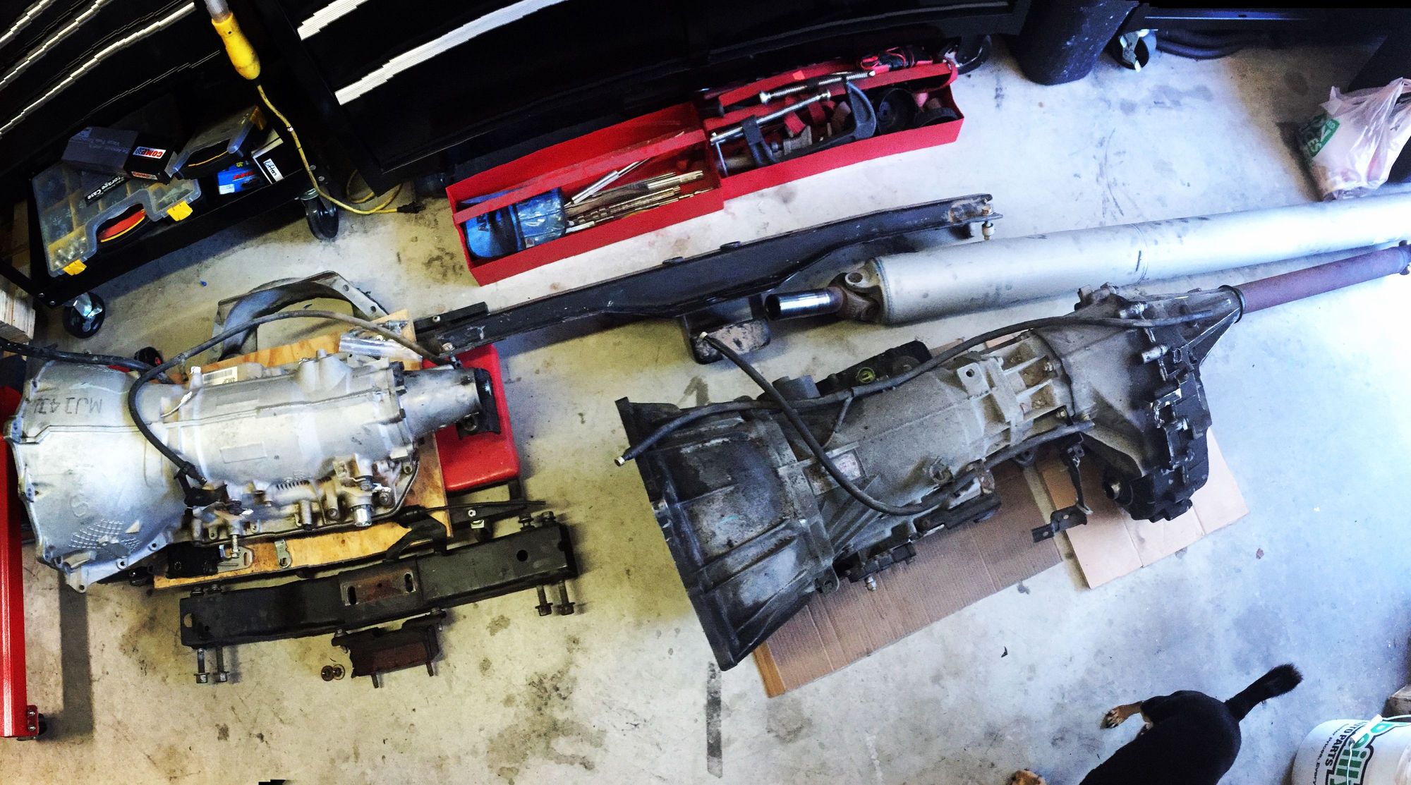

Pull the front and rear drive shafts, 65e and np149 t-case. Need to shorten the rear shaft and extend the front shaft or just replace it with a 2500 hd front shaft. The T-case is going to be separated, inspected, soft parts replaced and input shaft sent out to get machined to accept the 80e output shaft.
