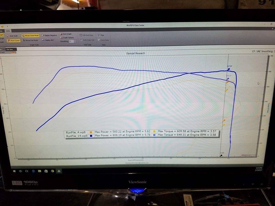

TVS 2300 @ 8psi, 227/231 116LSA cam, CNC heads, headers and now Methanol Injection. End result is 609hp/649tq at the rear wheels Launching in 4 wheel drive still gets a little sketchy...wiith the meth alone picked up right at 5ohp and 50tq at the rear wheels....you can see the before and after pulls...yellow is before and blue is current
