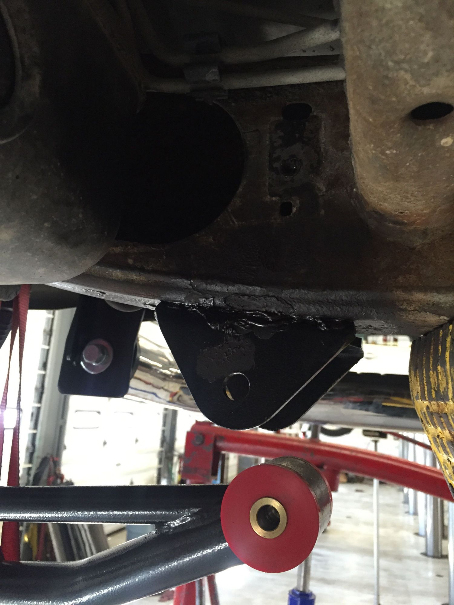

Thsi is where the brackets hit the frame... The raer bolt and the bolt on the side of the frame werent bad, its the front ones that were a pain especially the driver side, ended up dropping the evap canister to gain access to the hole in the frame.... I hit the frame with rubberized undercoating before i bolted the bracket down, i can make anything run...
