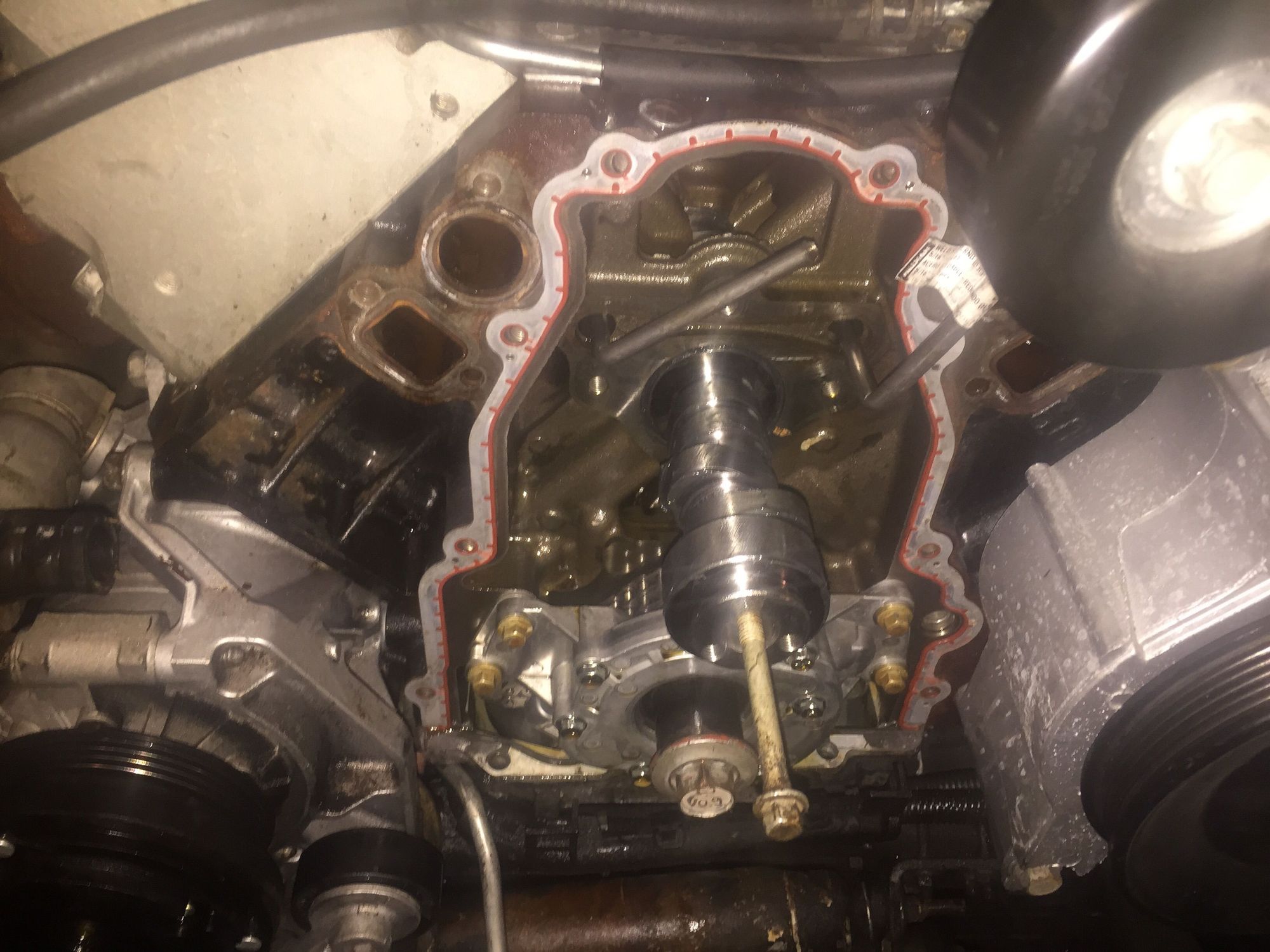

Unbolt the cam gear.... And wiggle it off the cam, you are going to need a heat gun or really hot hair dyer to heat the tnesioner up and make it pliable so you can compress it and put a pin or small allen key in it to keep it compressed....
