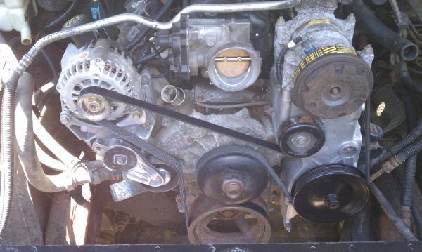

Success at last! A/C compressor mounts in "original" location for the truck so I didn't need to change the plumbing. The only bad thing ...I had to use a Ford belt tensioner because all the GM ones I found were spring loaded in the wrong direction.
