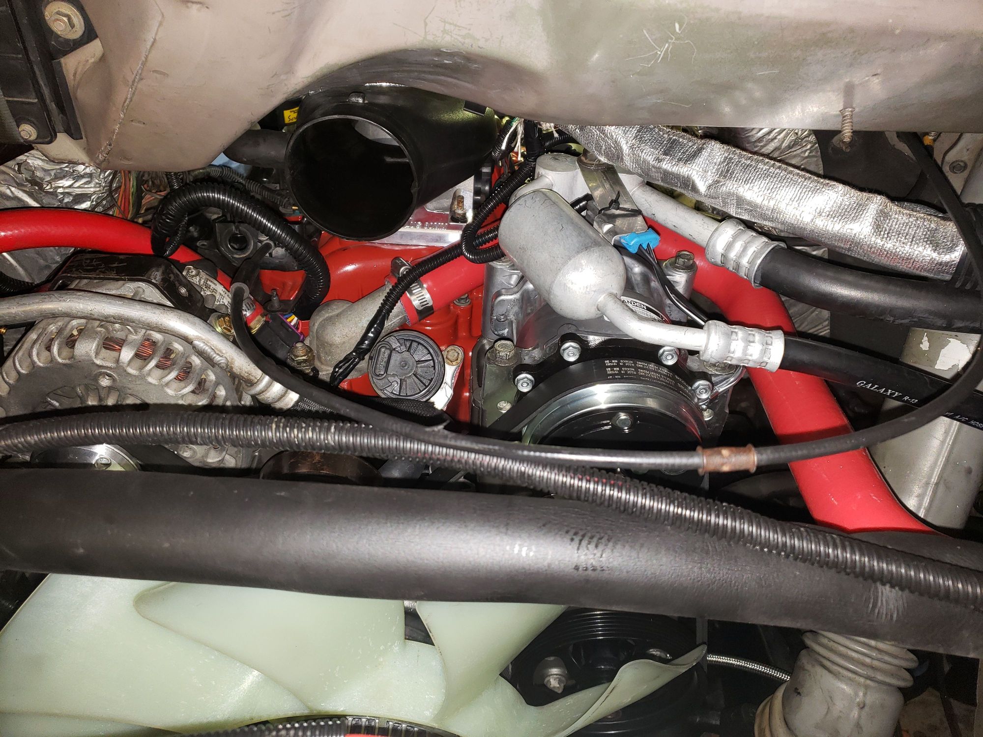

New sanden 4261 which is a SD7H15 variant at 9.5 CID per revolution with a 4.41" pulley. With the 6" crank pulley it turns 1.36x crank speed and has a maximum speed rating of 8,000 rpm and a maximum continuous rpm rating of 6,000. I have the PCM set to shut it off at 5,200 rpm or WOT.
