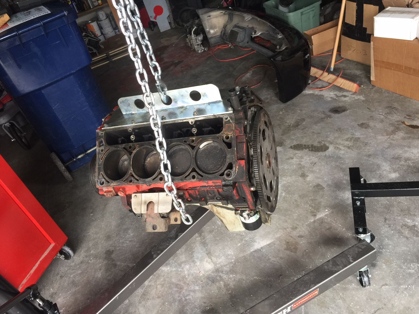

After you use a pry bar and pry the block off the trans. Mine was easy because if you read I just got the transmission redone. You can lift the block out. My truck has a 4/6" drop and I didn't have to take off the front end and used a harbor freight 1 ton shop crane.
