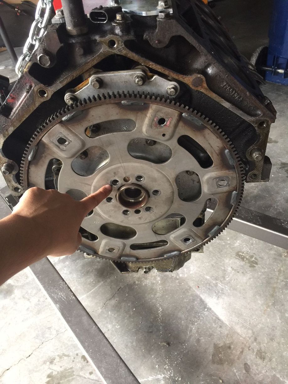

After you remove the 6 15mm bolts the flexplate needs to be pry'd off. I'm keeping my flexplate because it is brand new pretty much. Im not going to admit how long it took me to figure out it just pops off with some force.
