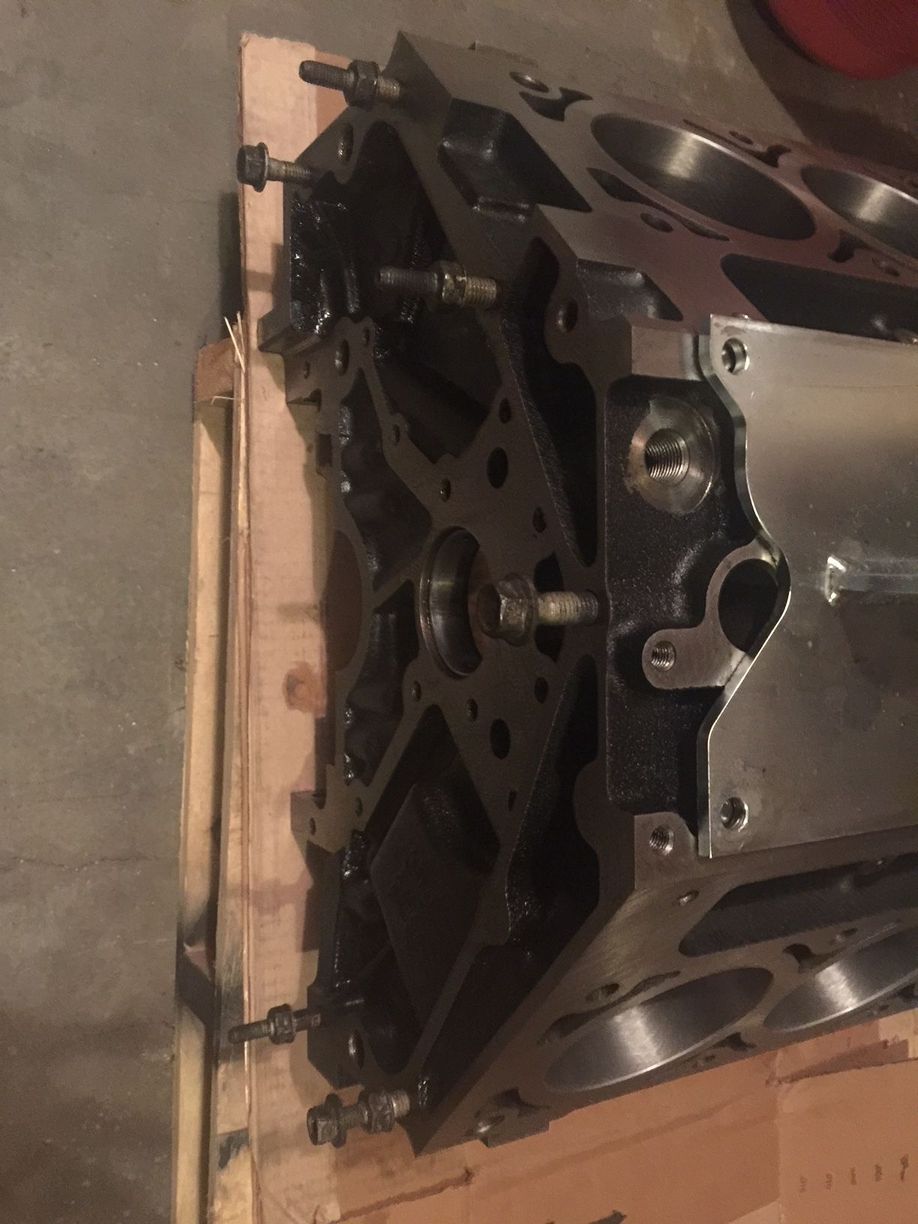

On my spare block I showed how my top bellhousing bolts were connected to my block. Note some bolts have a 13mm infront of the 15mm bolts. Also note a regular length deep socket won't fit you'll need a deeper than "normal" length socket on some of the 15mm.
