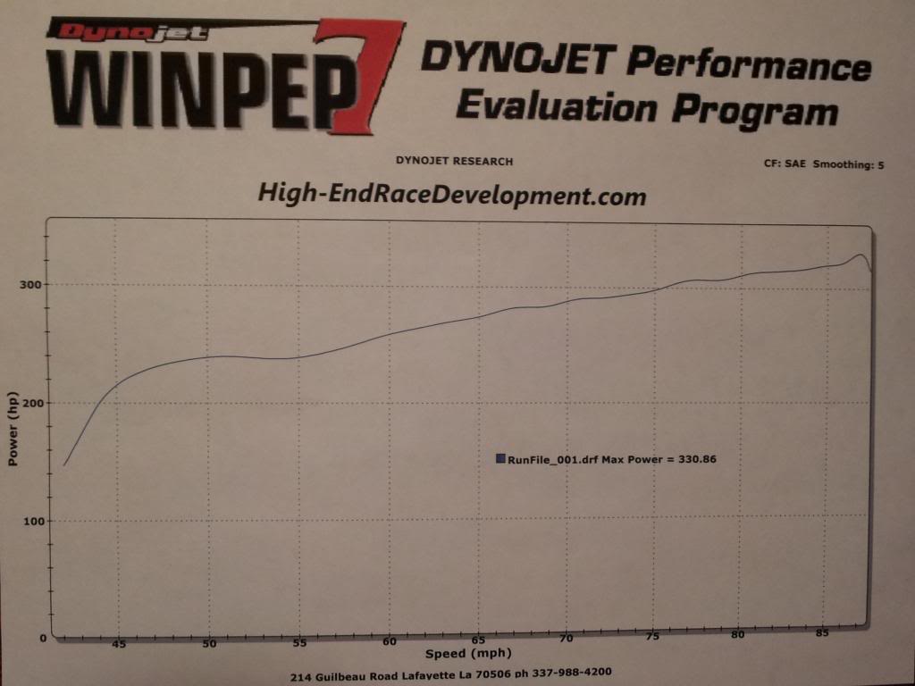

KHester84 Jul 20, 2013 08:02 PM
1 Attachment(s)
Well we had a good time at the dyno today, had a few modded cobras put down over 750+ swingit. It was a pretty full schedule and I didn't have time to change tunes between runs, I only ran the baseline tune which should have been about 16* of timing. The truck made 330 to the wheels @5psi unlocked in 2nd gear with the bigger tires, and from the looks of the plot I could increase my shift rpm a couple hundred rpm for sure, the power never peaked before redline at 5800 rpm. Too bad they couldn't plot rpm vs hp and torque. My previous dyno numbers were 250 with stock tires and tune only, so I'm pretty happy with the results.
Attachment 113072
