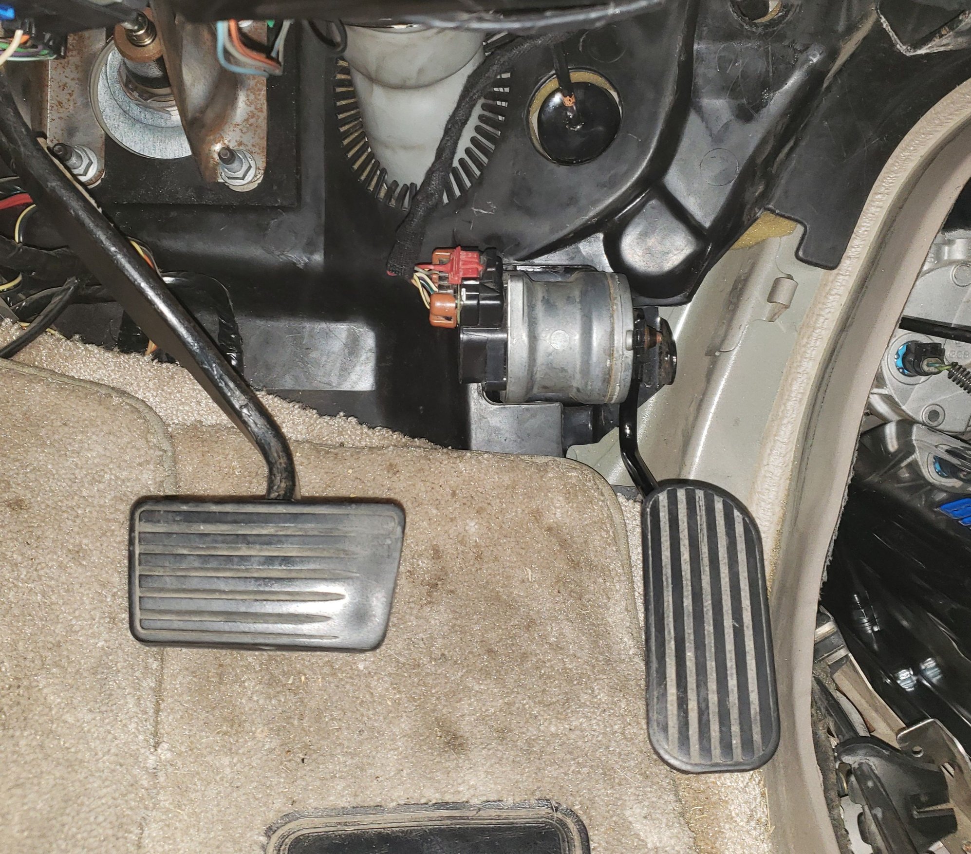

Looks like the C5 pedal sensor is the same style as my Express van that has the older 2000-2002 TAC module on it connected to the P59 running it. That early APP sensor was actually a 6.5L diesel part first. The Vette one has the same pinout just the connector faces a different direction. The early trucks including all 8100s with DBW used the older style pedal sensor like the C5 Vette used.
