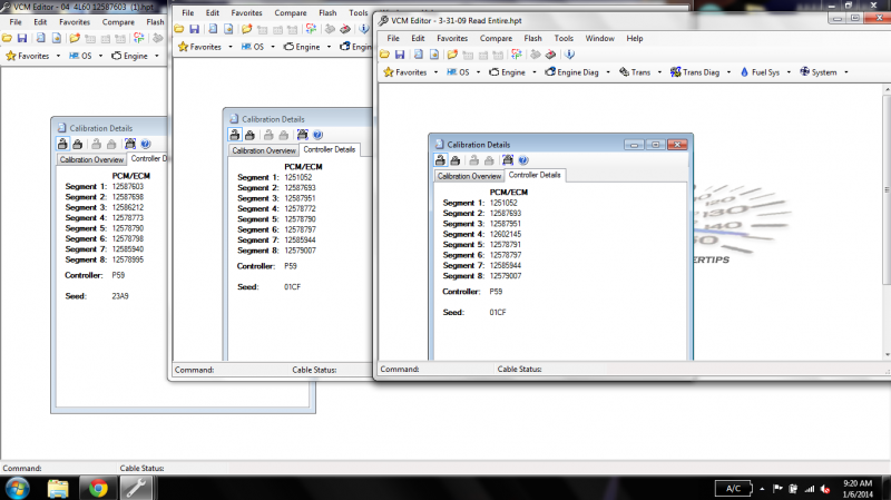

I am looking at your HPT ones, and based on what I see no. You do not need a PCM to do the segment swap, just with the software and loaded with Write entire. You have three files, first appears to be a basic 60E file with a 603 vcm OS, not sure what the story is on the middle one and the last one is a 2500 6.0 80e file with a matching 603 os so you could use the segment from the last file for the first file.
Comparing my stock tune with my 80E swapped tune, segments 4 and 5 are the changes.
Edit- Hold on now I am confused, maybe you did. Which is your desired starting file? The 60E file? It almost appears like you copied all of the segments rather then just the Trans segments.

Tune on left is the first 60E one you posted, Middle is my 80E segment swapped tune, right is a tune of mine with the 65E previously. Ignore segment 1 as it used to be 603 but I am now running a custom OS due to 2bar SD.
