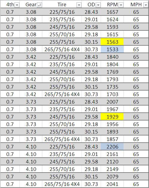

Oh FYI mine has the 3.73 and it cruises at around 1400-1600 @55 <Digital reading not analog. It doesn't seem to make enough torque around that RPM to drive the truck good though.
