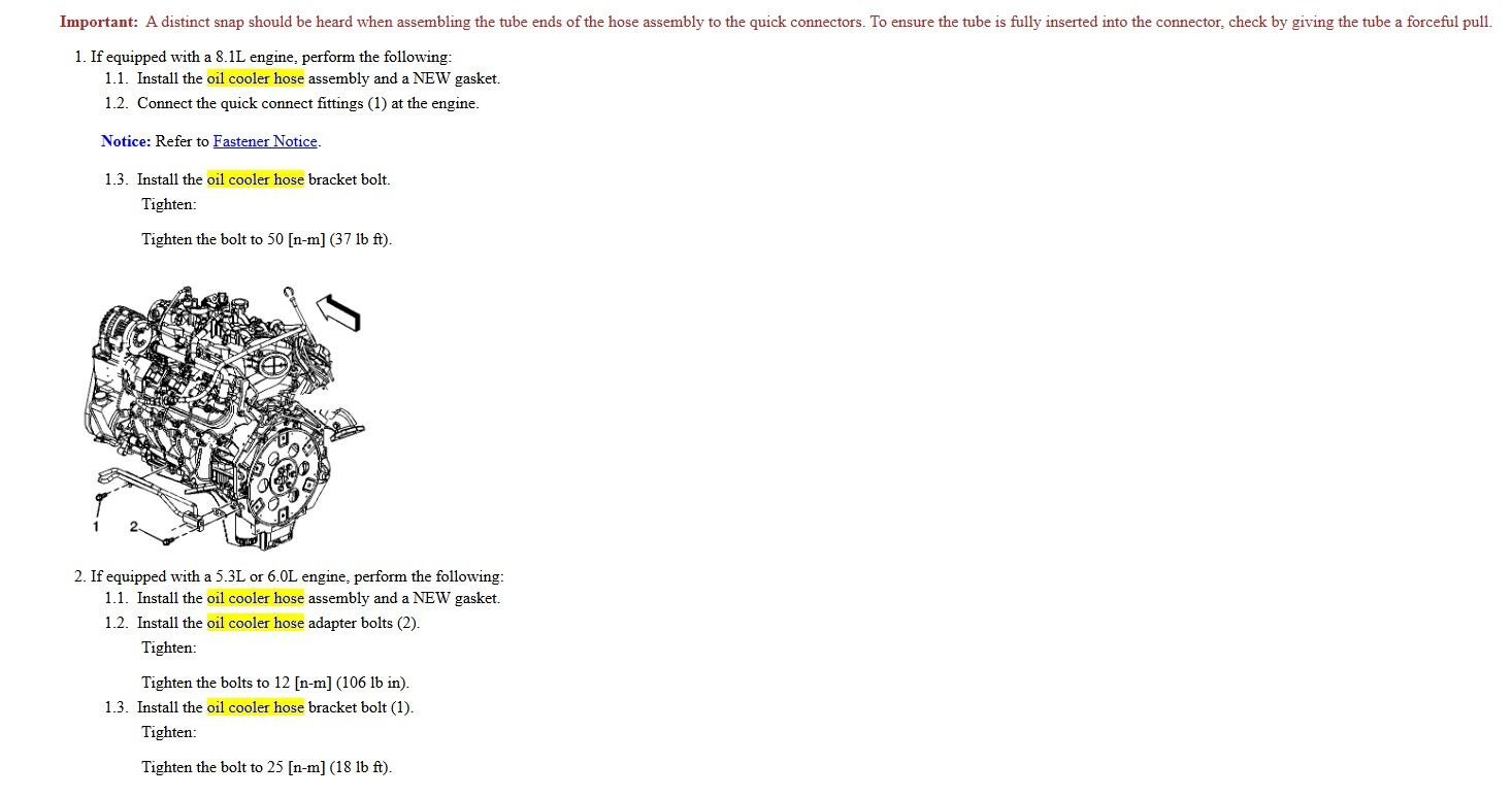

Thanks for the screen shot.... looks like the bolts call for 106 In Pounds of torque
106 Inch-Pound (in∙lb) = 8.83333 Foot-Pound (ft∙lb)
I think my torque wrench only goes down to 20 foot pounds, so I'll need to get one of those itty bitty torques wrenches

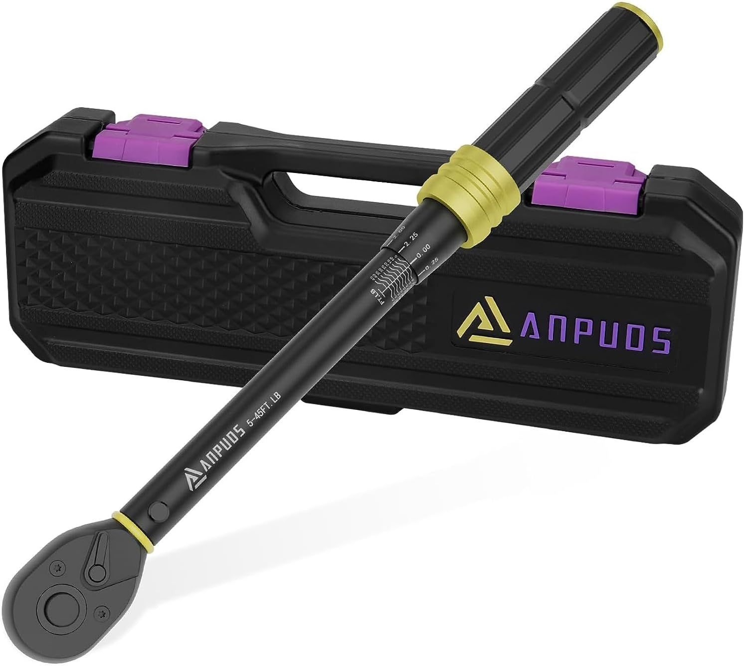

I just bought this guy on Amazon... it does 5-45 Ft-Lb
Amazon Amazon
It looks like a nice EL Cheapo brand torque wrench and has good reviews.
