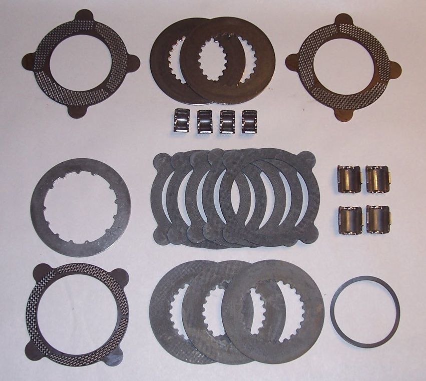

Ok guys i looked in my newly purchased tahoes axle it does have the The g80. It however does not work. The clutches are shot. I would like to see if it is possible to turn it into a full time posi. Like replacing the disks and removing the governor parts and installing an s spring. Its either that or fork over the money for a 9.5 sf which is kinda off the table right now. So does anyone know if this can be done and what parts i need.

There is a company that offers kit to
do rebuilds or full time changes. I can't
think of there name off hand. I will search
my files for there name for you. check out
betperformance.com
Attached Thumbnails turning the gov bomb into a full time posi-gov-loc-rebuild.jpg   turning the gov bomb into a full time posi-gov-loc-repair-kit.jpg

An old dirt track racer showed me this trick. Remove the centrifugal weight setup and install an Eaton preload plate kit. I actually did this on another rearend in my 68. It actually worked pretty well. It essentially converts the G80 "locker" to a limited slip.
