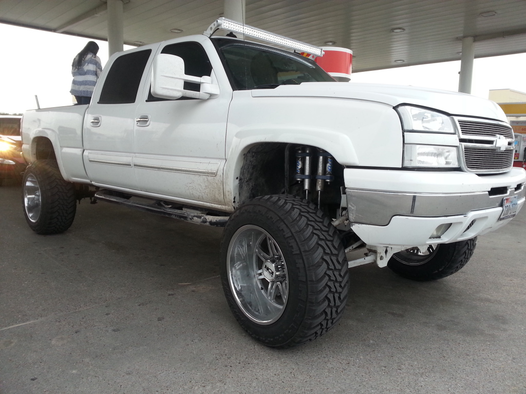

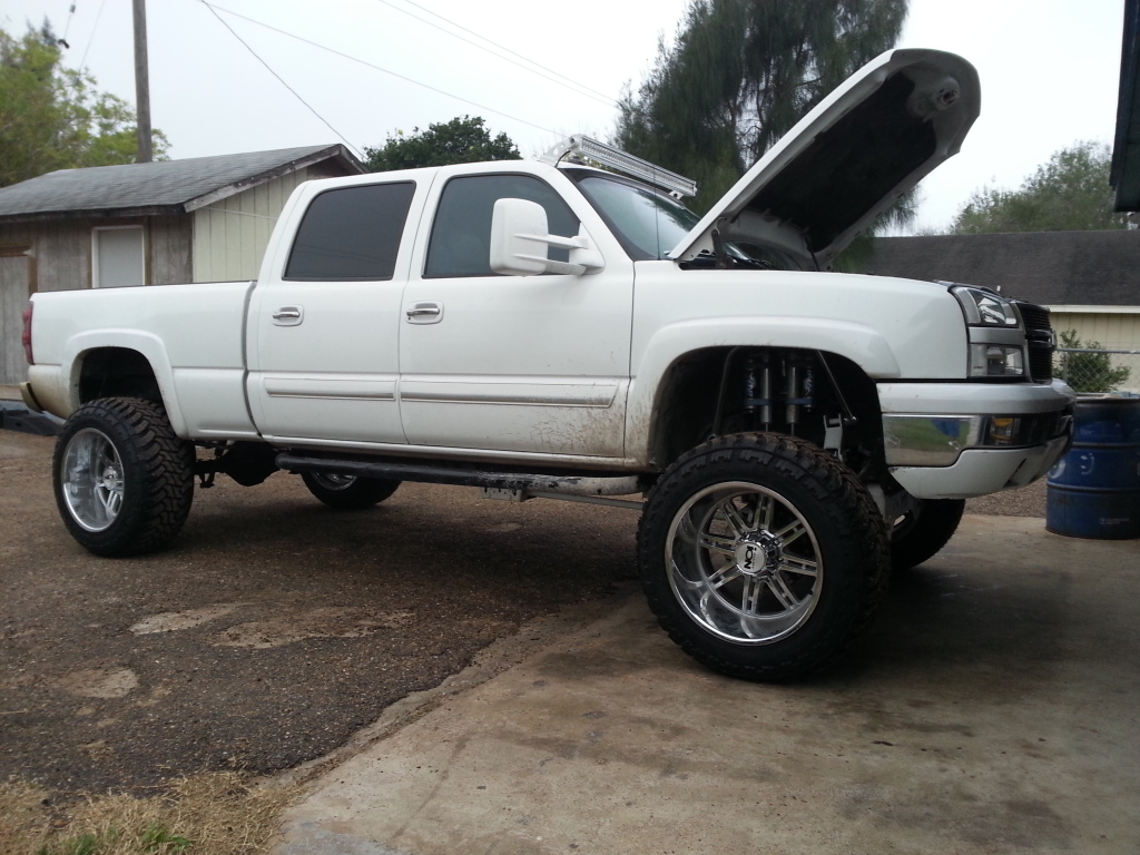

Put on some 37s this Christmas when i went home now it feels heavier than before need to regear it and thinking I need some type of FI I like the way it looks but just thinking about it and I think I'm gonna need a diesel

Gears will make a huge difference. With 37's, I'd go 4.88s.

i have 35s and just swapped to 488s, so far i love it with no load on the back...Made truck very light feeling this is also with a 6l80

Some air bags might help to keep your headlights from pointing at the sky.

I like the way it sits like that with a little lean back it's not much like an inch just looks like more in the pik and it's cause I had a bunch of stuff in the bed in those piks transmission and other car parts. It does have air bags in the back just don't like the stiff ride when they're all aired up and the truck is empty

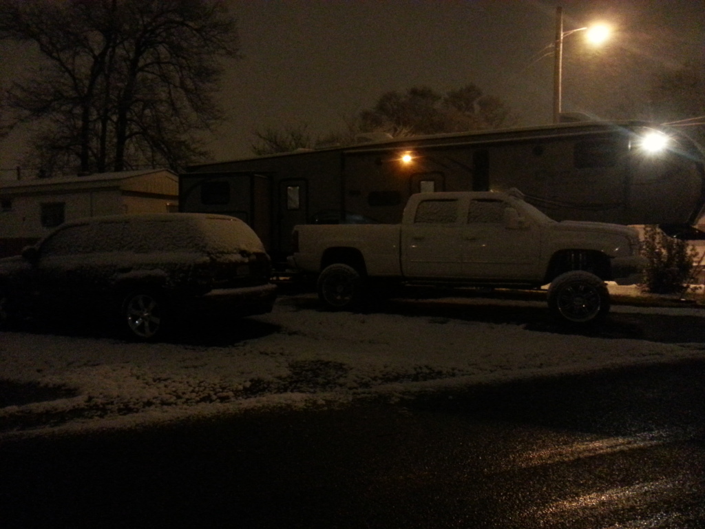

Given we both have Crusaders - I'm wondering how your 5er works with your lift? Seems a bit high.

Here's some piks of how my truck sits next to the 5er

That's why i was asking cause I haven't towed it with my truck but my crusader sits pretty high when i bought it a few months ago I had them deliver it cause I didn't have a hitch yet but I'm hoping it should work fine when I bought mine they're was a lifted dodge there that also took a crusader and didn't look to bad. Whenever I get a weekend off work I'll have to hook it up and see how it sits, and yeah it was fun when we worked in Freeport lived like 1/2 mile from the beach
