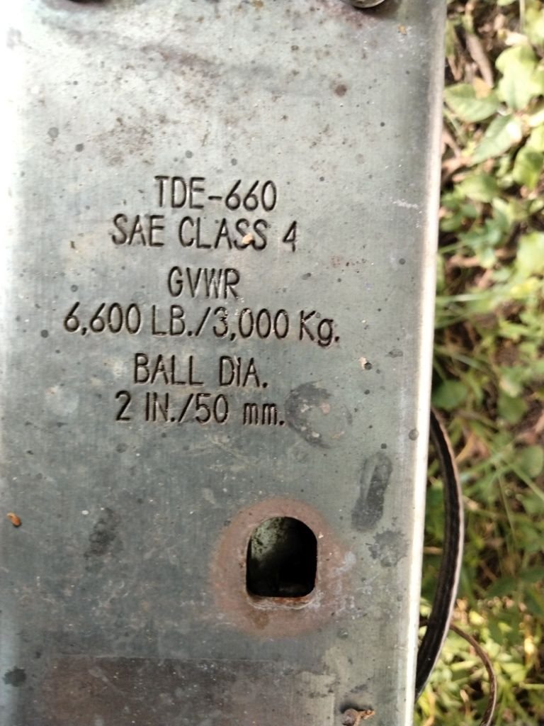

here's the 4"drop ball holders specs.using a pipe wrench an long cheater pipe I just removed the 2 5/16" ball.
the trailer tongue coupler needs a 2" ball.
I think all I need for the 4” drop ball holder is a 2” ball w/ 1 ¼”x2 5/8” shank
