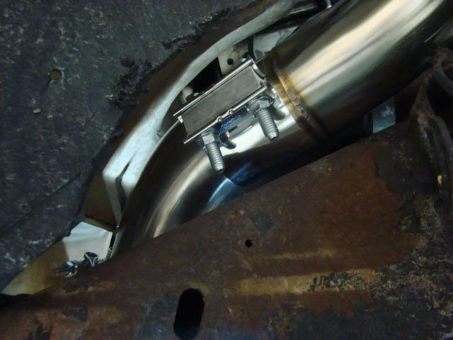

On to the solution, when installing the downpipe, you will need to make one cut. There is no welding involved so please do not be alarmed. Take a look at the photo and note the location of the cut, its ~1.25” past the weld. This straight section needed about 3/8-1/2” extra in length to push the lower v-band past the crossover pipe. The stainless steel lap band we will send out makes up for this difference and will provide clamping force between the two. We use this style is a lot of our systems post-turbo to allow for more adjustment.
Attachment 100651
This illustrates how the clamp will sit when installed on the truck. You mainly just want it right in the middle of the straight section so that the clamp isn’t on the bend.
Attachment 100652
