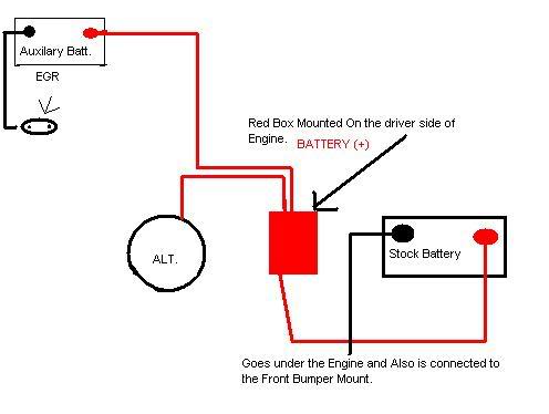

Here ya go... and for anyone else that wants to know.
Attachment 138509
Yes i took time to draw a Schematic up in Paint ( :) )

Red Wire (Hot) runs to the engine cover, Under it and comes out in this loom..
Attachment 138512
Then connects inside the lil red box.
I dont have a pic of where i mounted the Ground for the AUX Battery. But my Paint Schematic Special shows that.
I had enough Red wire left over i ran some from the ALT to the Red Box. Figured it wouldnt hurt to replace the stock 10ga stuff, Or was it 12ga? That stuff is small for sure.
Wire is 6ga Red and Black.
Total cost: ~$80

Pailess Wiring also has a dual batt setup I used on my 92 and 99 silvy's, and worked flawlessly. Could charge one, both, and use one or both to start the truck. Basically allowed the use of two different batts ( i had one yellow top and one red top Optima).
This is the key thing....if you use the setup like Nonnie used, you need to used 2 of basically the same exact battery, in pretty much the same state of health. The weak one will kill the strong one in the long run much faster.
truckmann 01-28-2007 10:20 PM
I think using an isolator, which the painless system must come with should be a must. It's a good safety measure and if wired correctly you can run one battery down completely and still use the other battery to start the truck. Surly a stock setup comes with an isolator?
