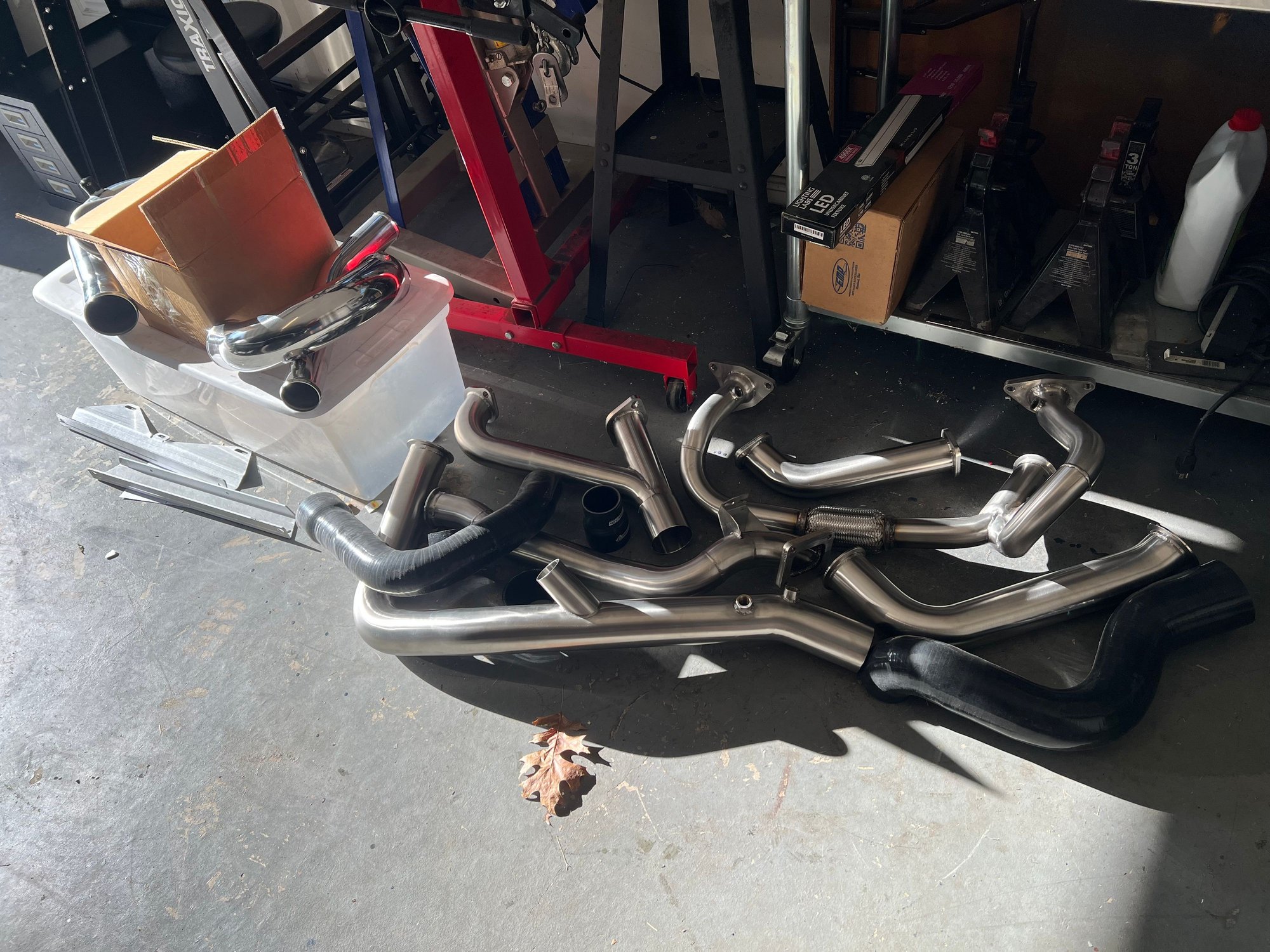

Bgbldodge Jan 28, 2025 03:03 PM
Turbo'd Tundra
This:
https://www.turbokits.com/2007-2021-...kit-600hp.html
https://cimg6.ibsrv.net/gimg/www.per...c384f5a64f.png

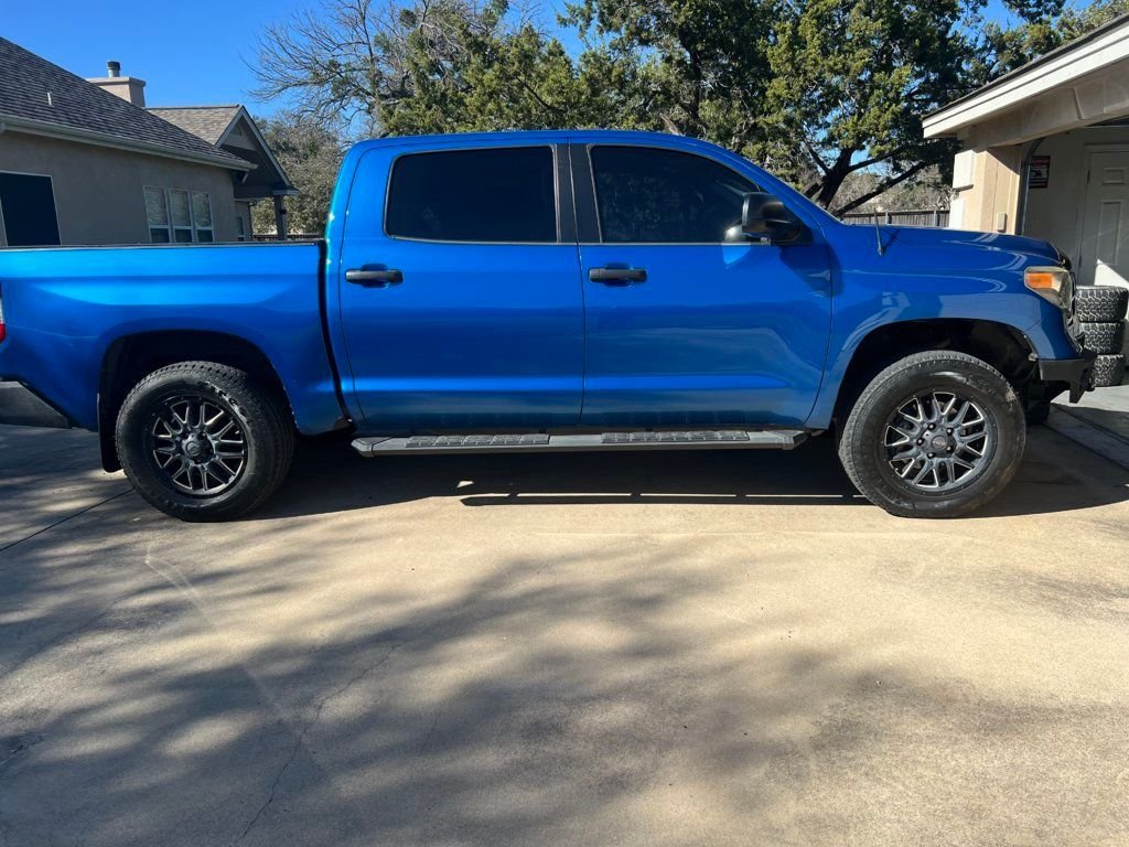

Is going in this:
https://cimg9.ibsrv.net/gimg/www.per...b99cfe404d.jpg
My 2018 Tundra. 5.29 gears with true dual equal length 3" exhaust. Turbo is a precision LS7675 T4. Going with some Deatschwerks 650cc injectors and water meth. This kit is brand new and is only out there on 2 other trucks I'm aware of so still in the testing phase. I needed some speed and it was either this or a corvette and a corvette can haul 2 kids around so here we go. Planning on road tripping towing the rzr in March to Arizona so it's going to get a work out. Kit delivers Friday.

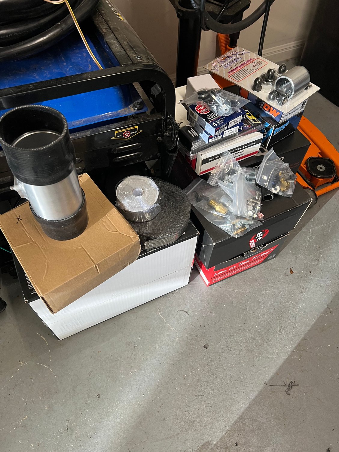

https://cimg8.ibsrv.net/gimg/www.per...d7e443158.jpeg

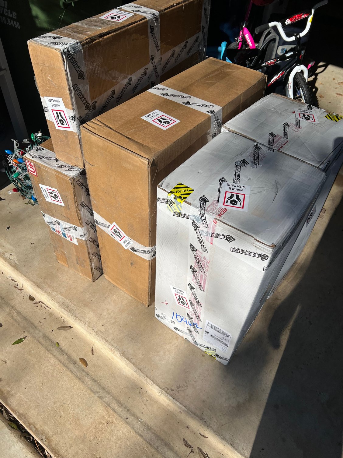

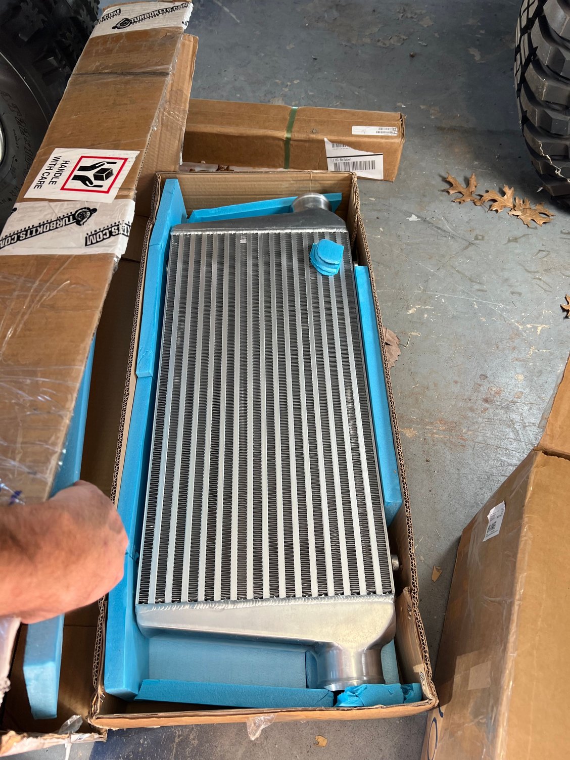

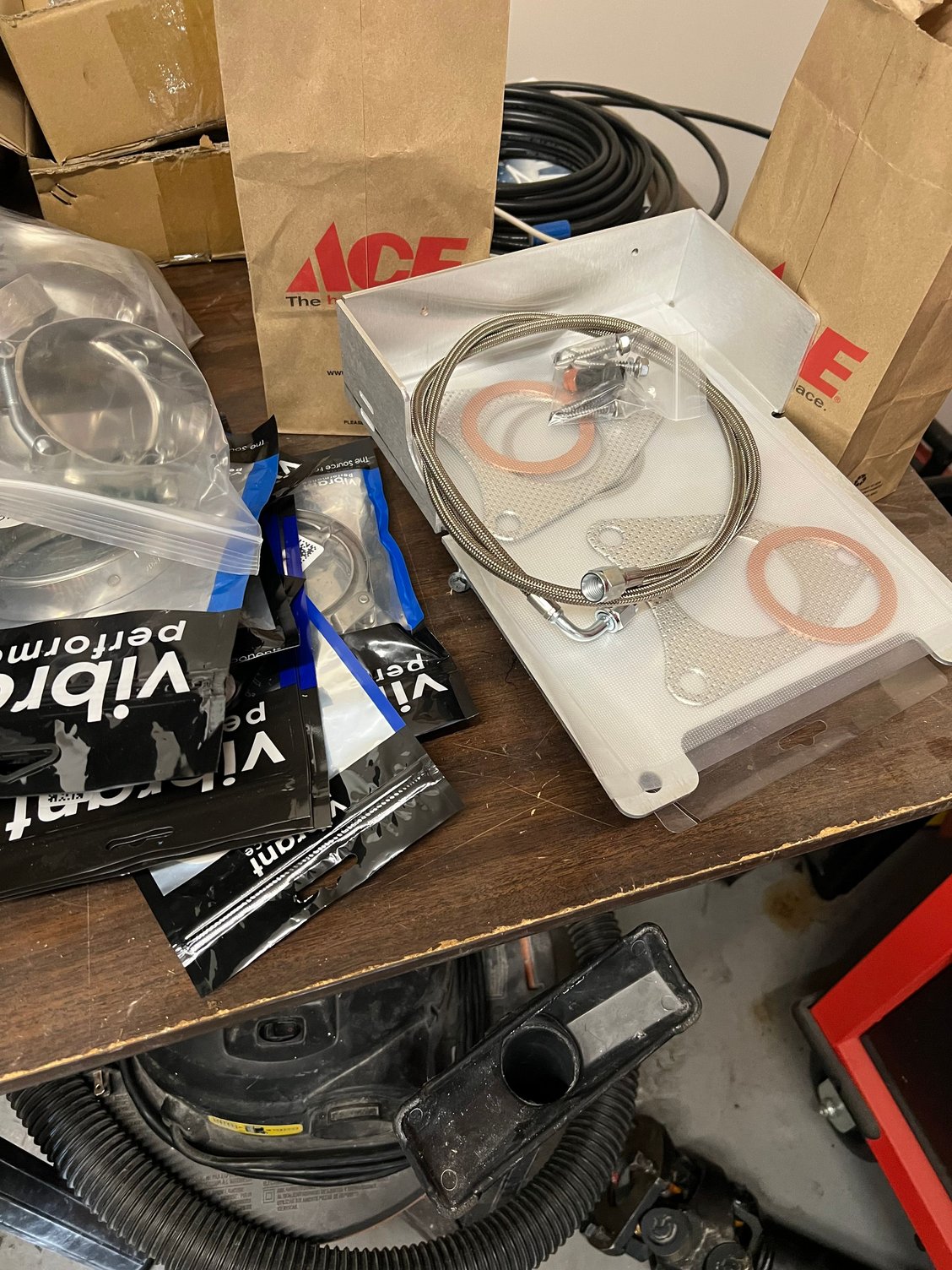

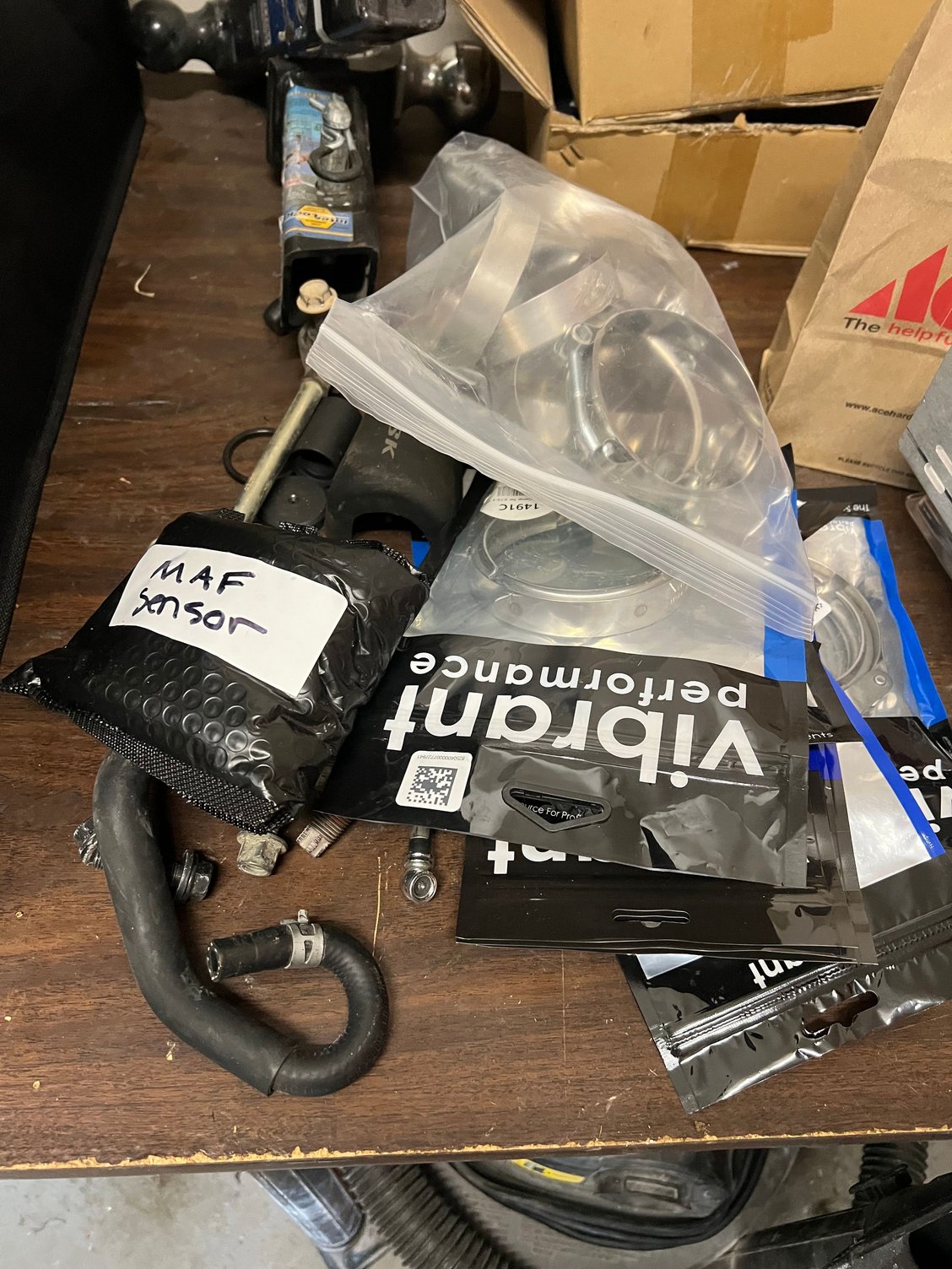

Bgbldodge Feb 2, 2025 05:47 PM
https://cimg0.ibsrv.net/gimg/www.per...d1b55ba3c.jpeg
https://cimg3.ibsrv.net/gimg/www.per...677ae5a24.jpeg
https://cimg7.ibsrv.net/gimg/www.per...303a5b42f.jpeg
https://cimg0.ibsrv.net/gimg/www.per...64add0664.jpeg
https://cimg3.ibsrv.net/gimg/www.per...378d70bcb.jpeg
