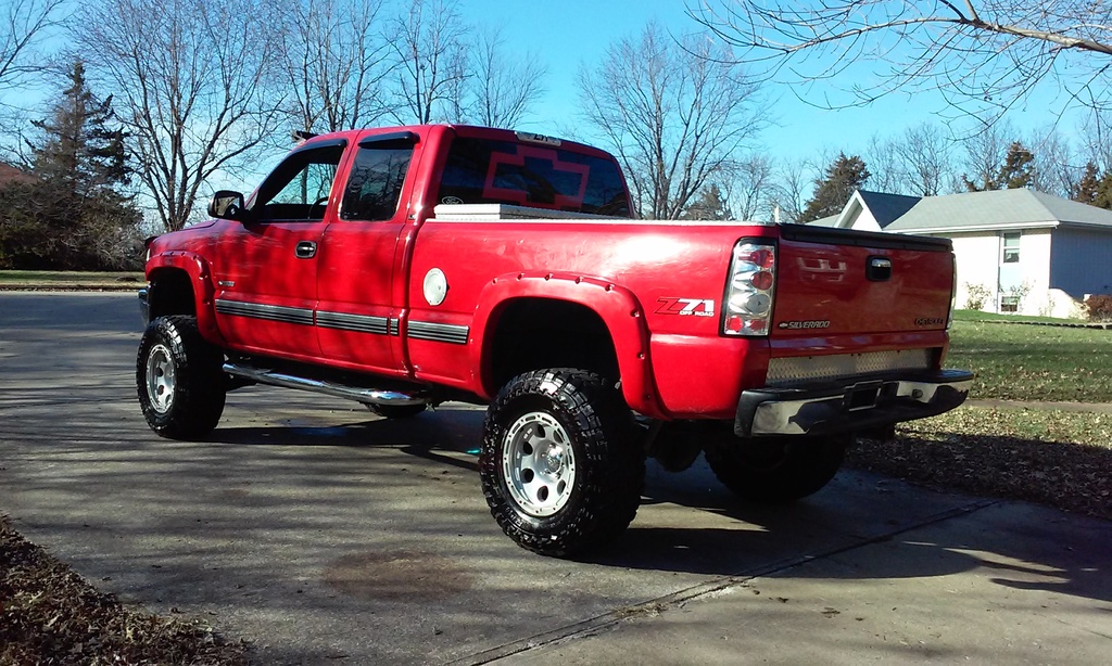

Thinking about going this route with my new truck.
