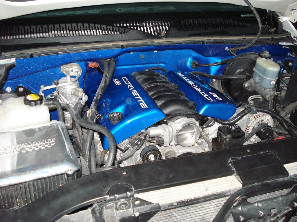

I started out by taking a 2000 Reg Cab Short Box 2wd pickup that came in on trade from a sale in April. We started almost immediately on the tear down of this truck and I started ordering the goods. I decided I wanted to go the route of a corvette drivetrain in a truck. So I ordered a GM Performance Parts LS3 with GM's Hotcam. Rated at 480HP. Backed that up with a Finish Line Stage 4 4L60E Transmission from Chuck at FLT. 3600 Yank Converter from Dave @ Yank Converters. Rearend just has a Zexel Torsen T2-R Carrier, 4:56 Gears and a TA Diff Girdle.

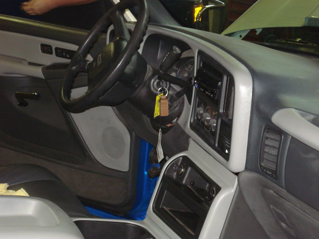

Other few goods and specs are a 3" Dynomax Ultra Flow Muffler fed by Hookers Super Comp Ceramic Coated Headers. There is also a QTP Electric cutout in the system too. Interior was takin out of a 2005 Sierra Crew Cab from a local wrecking yard. The fun part was the wiring for windows and seats. This truck was a plain Jane when we started out, now she has all the good stuff. Two toned the leather seats and some of the dash pieces.

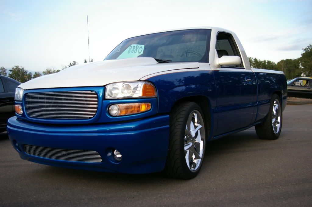

Wheels and Tires are a 22x 9.5 Foose Impression wrapped in BFG KDW's. 14" SSBC Brake kit on all 4 corners and a line lock to save the rear pads. Truck was lowered 2" in the Front and 4" in the rear.
Paint and body was all done from another buddy here at the Dealership. He is a licenced body guy but this was only the second vehicle he has ever painted. I think he pulled it off perfectly. Shaved T.Gate, Goodmark Cowl Hood, Street Scene sport mirror, shaved B pillars and 3rd brake light. Paint was done with Corvette's Jetstream metallic blue topped with Cadillac Diamond White and split with corvette's Atomic Orange Metallic. I ended up fitting the front clip off on a Denali Pickup onto this truck as well with billet inserts.
Supplied Wiring harness from John @ Speartech. Me and a buddy at the dealership did the whole install of the drivetrain except I sent the truck up to Lyndon Westers of Westers Garage in Tilley, AB. What an amazing install they did and driveability is unreal. Any questions or comments I would love to hear and try to answer for ya.

It was build mainly for PR for the dealership this last season. Probably just take it to some local events and races. Owner uses it for just rippin around in the summer time. I ran a best of 13.3 @ 102MPH. Does have a price tag on it of about $55,000 but tough sell when there is a foot of snow on the ground right now.

60ft was hard to keep it from spinning, with a sticky tire I'm sure we could have it in the high 12's. 31" Tall BFG wouldn't hook to save it's life. No traction devices either.
