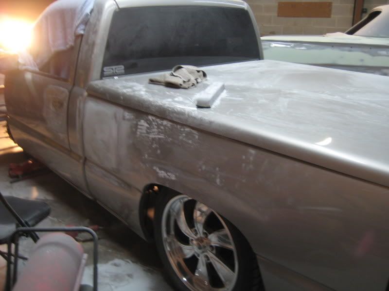

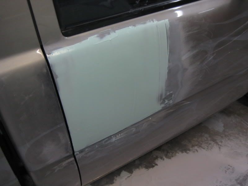

first layer of duraglass sanded down
http://i45.photobucket.com/albums/f6...411/fs2011.jpg

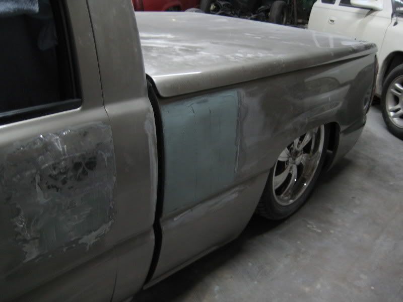

beginning work on the shaved gas door
http://i45.photobucket.com/albums/f6...411/fs2012.jpg

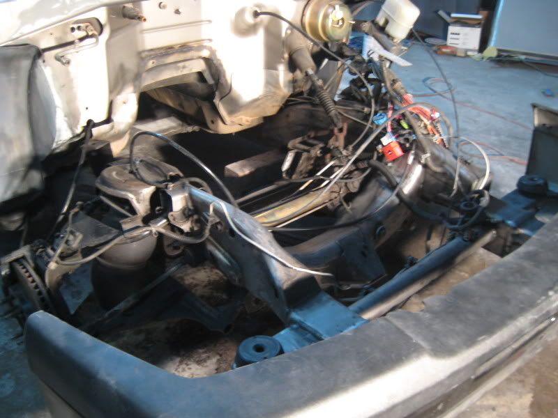

while i was working on the body work, my dad was scraping the frame for paint..
http://i45.photobucket.com/albums/f6...411/fs2014.jpg
http://i45.photobucket.com/albums/f6...411/fs2013.jpg

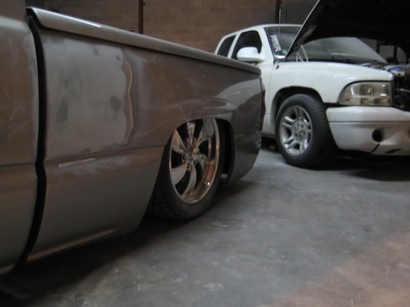

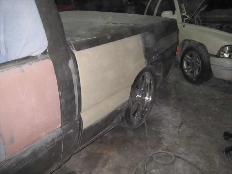

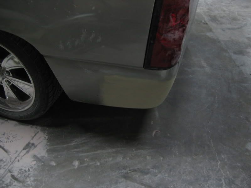

a little more work done on the gas door.. these things were warped BAD
http://i45.photobucket.com/albums/f6...411/fs2022.jpg

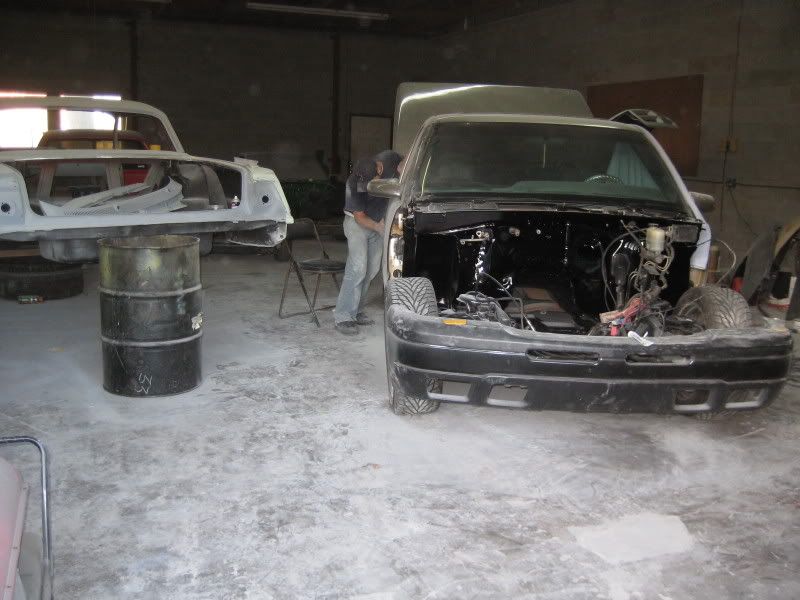

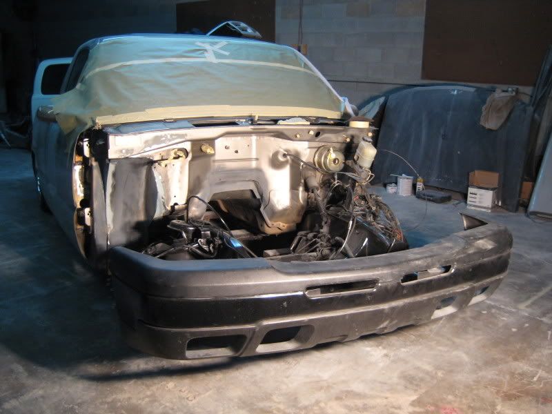

this is how she sat through the process
http://i45.photobucket.com/albums/f6...411/fs2023.jpg

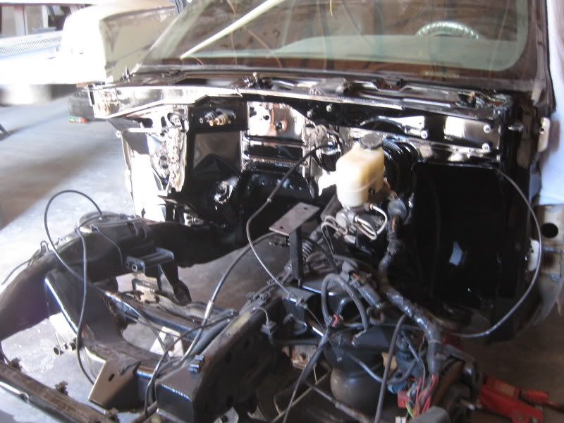

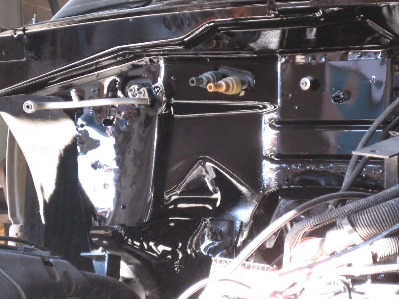

firewall painted
http://i45.photobucket.com/albums/f6...411/fs2041.jpg
http://i45.photobucket.com/albums/f6...411/fs2042.jpg

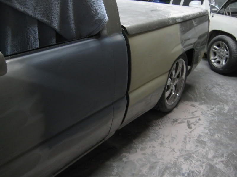

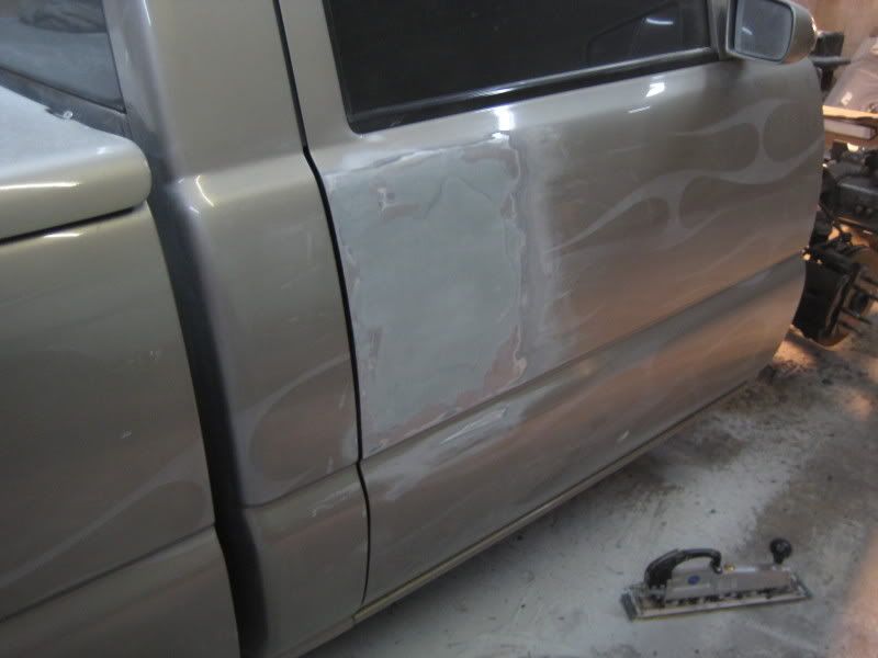

final wipe of glaze coat on the passenger door
http://i45.photobucket.com/albums/f6...411/fs2079.jpg

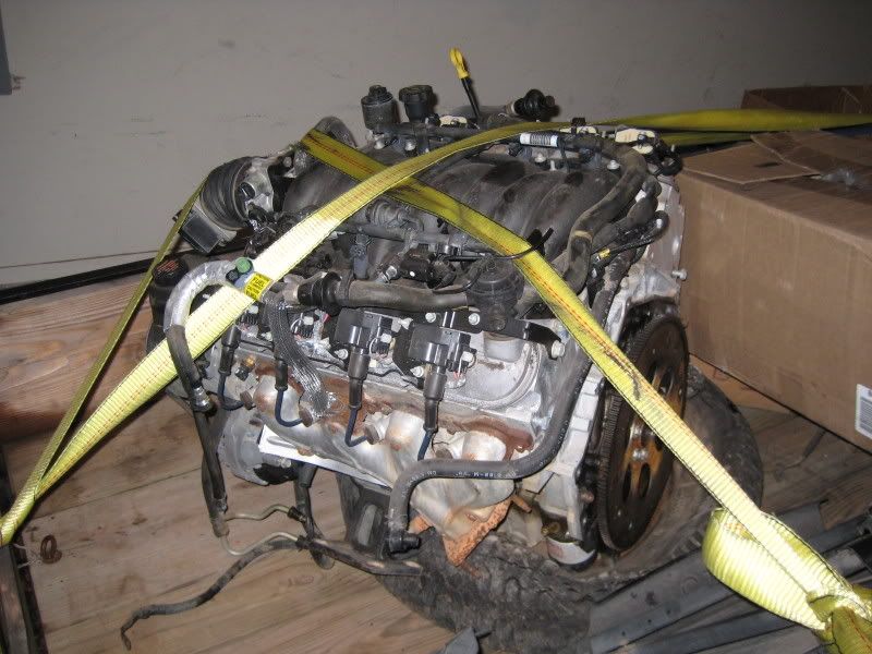

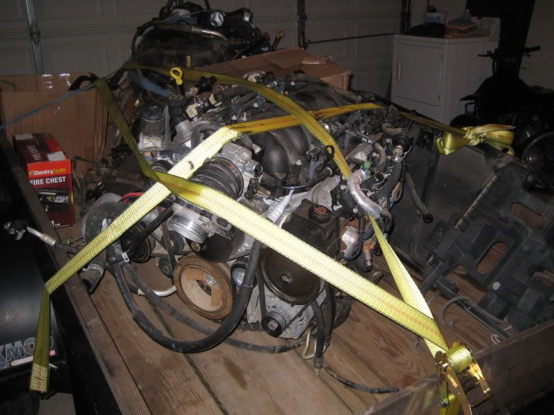

and the ls1 that is going in.. along with a built tranny and a few other goodies
http://i45.photobucket.com/albums/f6...411/fs2151.jpg
http://i45.photobucket.com/albums/f6...411/fs2153.jpg
moregrip Jan 22, 2009 10:56 AM
looks awesome....how was scrapping the frame?
pewter00 Jan 22, 2009 11:01 AM
scraping the frame wasnt bad.. just spray some carb and choke cleaner on it and scrape with a putty knife
