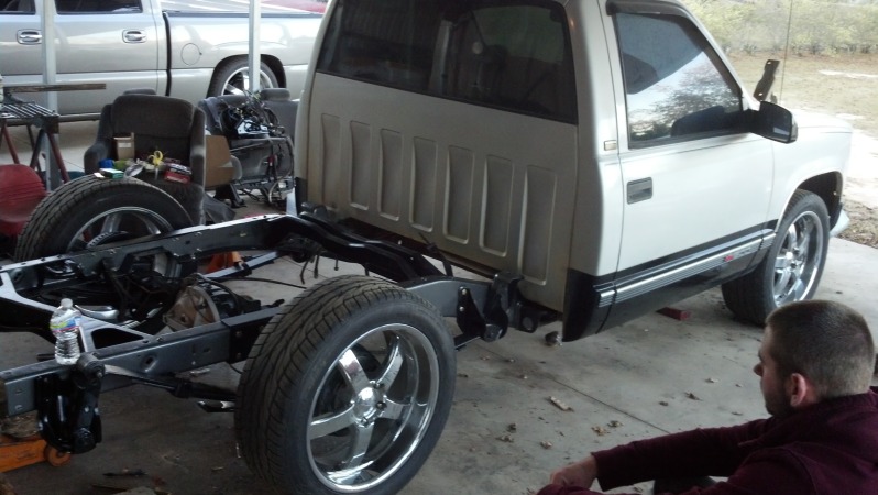

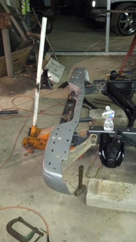

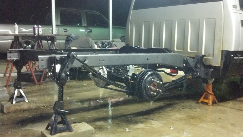

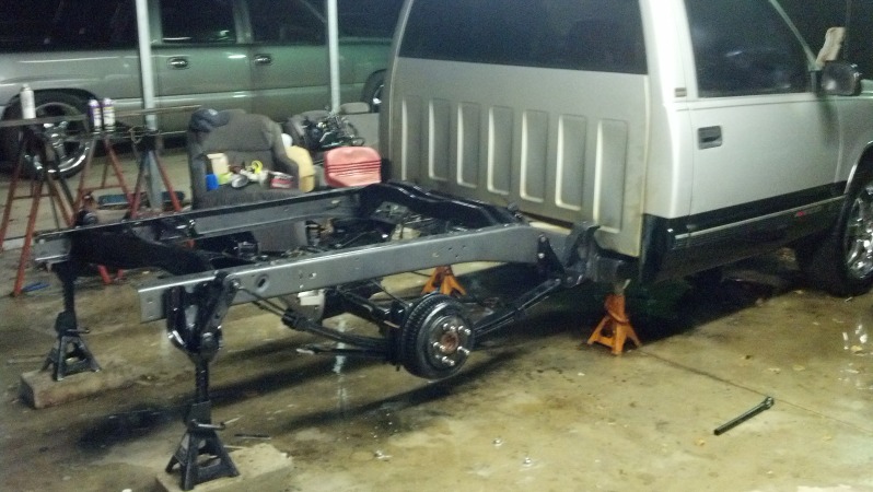

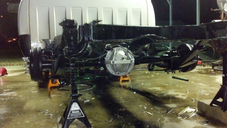

Did a lil work.
Got the springs and rear back under it, flip, notch, played with some nbs bumper fitment.
