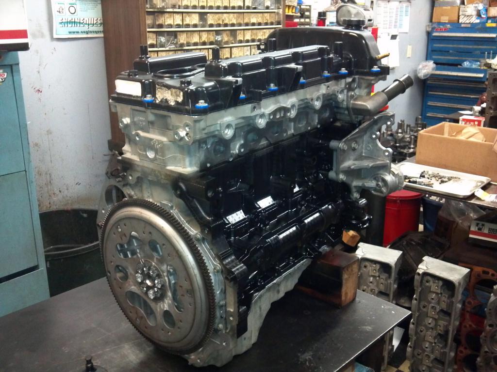

When we were at Throwdown that year, we melted two pistons while racing. It was heart breaking after the effort that had been put into the truck that year, but we towed the truck back to Motor Machine and started from scratch. We had custom forged pistons made, forged connecting rods, ported the head, polished the crank, all the fun stuff. It took months of waiting on the pistons, but we finally got the motor back together and on the dyno where it then proceeded to turn the #3 cylinder sleeve into powder in the oil pan. Motor #2, gone.

At this point, I was beyond ready to give up on the motor and just go back to stock, but I held out, waiting to see what the parts manufacturers were going to do, and after many more months of waiting on those jack holes, we finally got a new set of pistons. We then started with a fresh, low mile block and got to work. The truck had been down for a year at this point, and oh, we had already been invited back to compete in Throwdown 2013. Well, everything that could go wrong, did go wrong. The rings that the piston manufacturer sent were the wrong size, and when they red labeled us a new set, they didn't even include the oil rails. 5 days left to Throwdown. The guys at Motor Machine were able to pull a set of oil rails from a stock set of pistons and make them work. Once the motor was back int he truck, the charging system refused to work. Two days were spent working on that problem when it suddenly and miraculously, just solved itself. All they did was flash a new tune on the ECM and none of the parameters in that tune file could have affected the charging system. Either way, we were happy that the truck moved under it's own power and was making power; 335rwhp on 12psi of boost.
